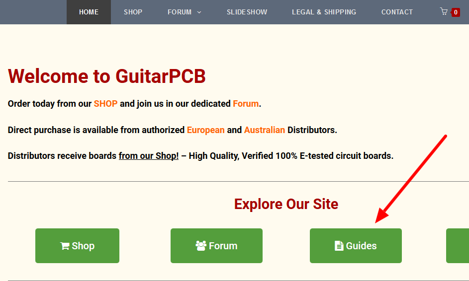

That said here is just one Photo (of many) from the GUIDES PAGE:
Easy Access to the GUIDES PAGE
