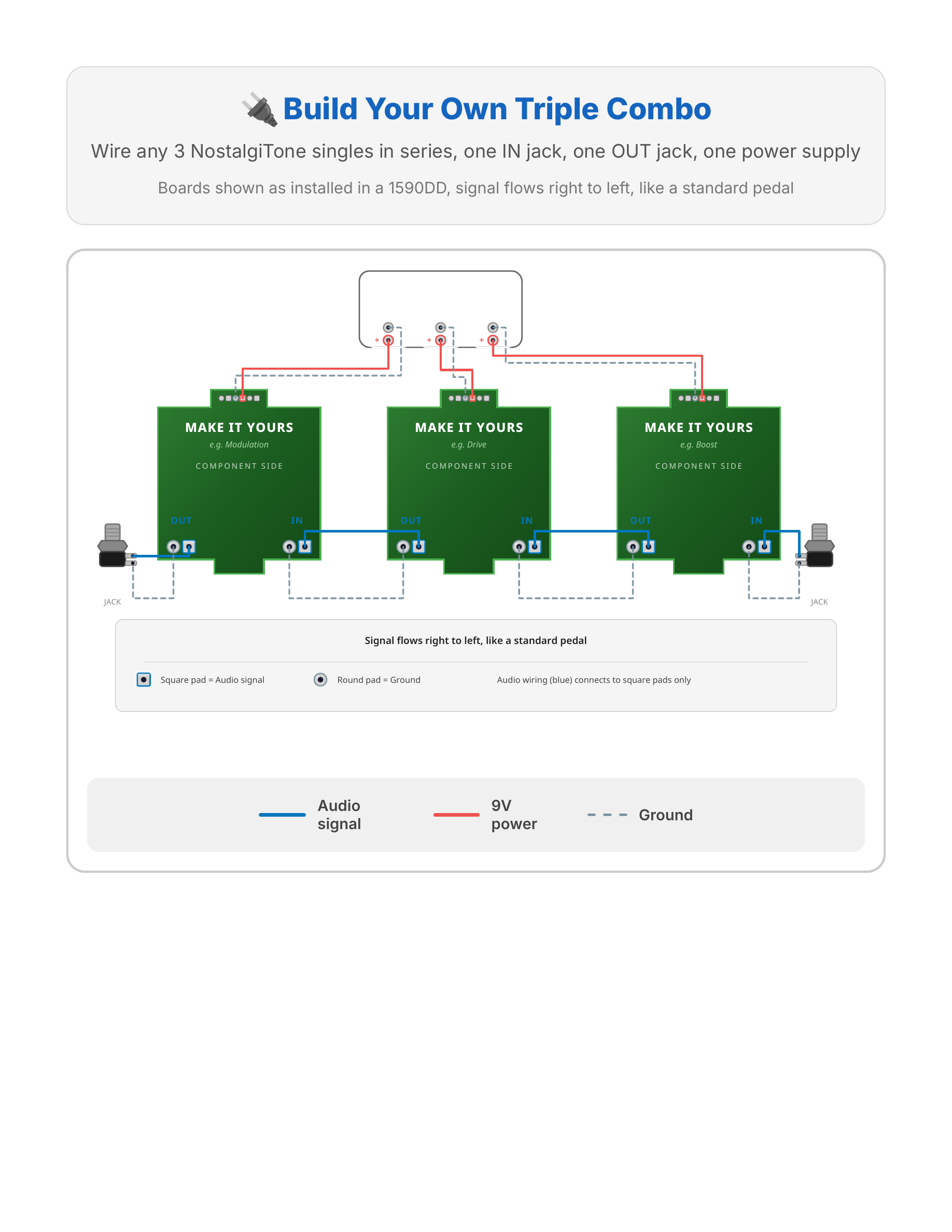

Hey everyone,

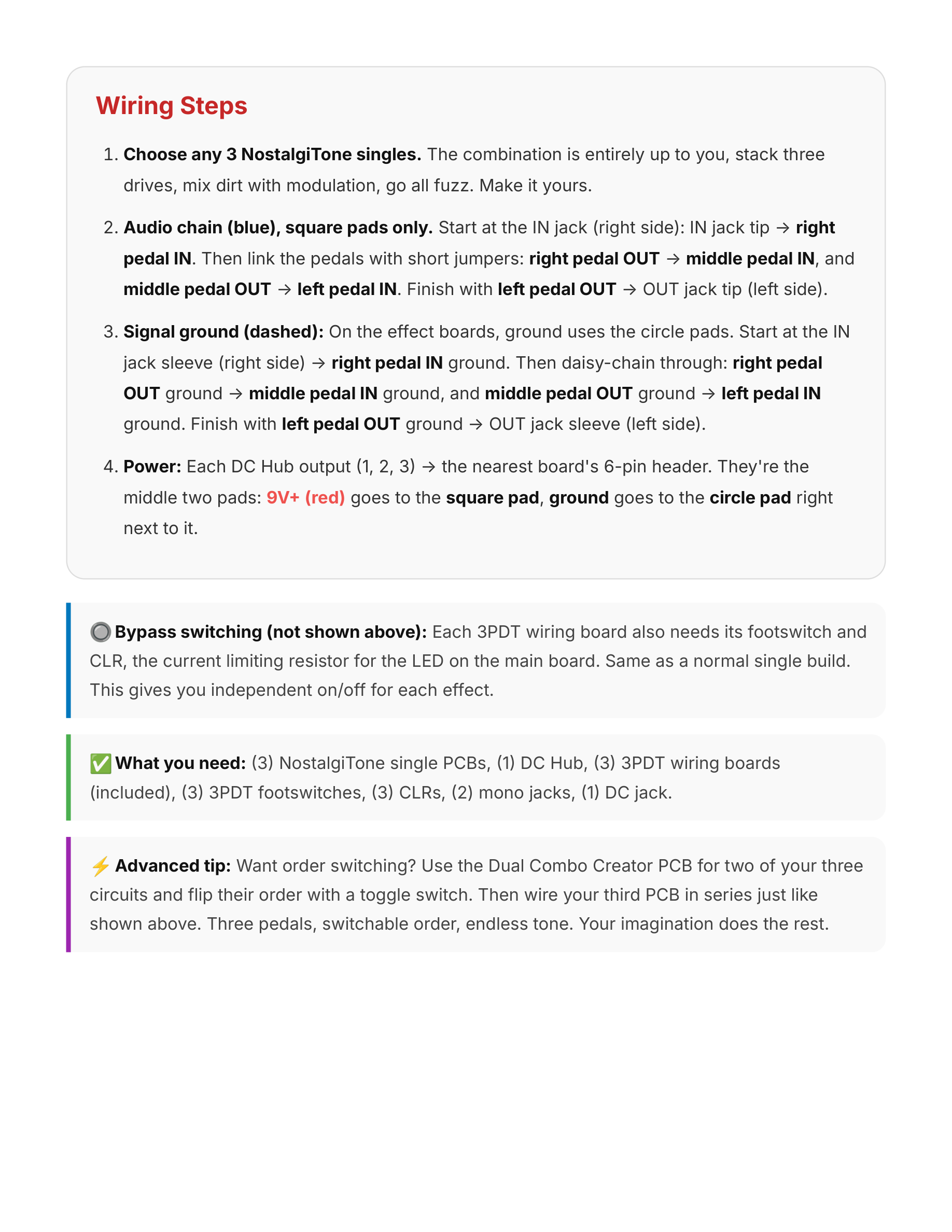

I put together a wiring guide for building your own triple combo out of any three NostalgiTone singles. Instead of being locked into a fixed triple PCB, you pick the three circuits you want, wire them in series with one set of in/out jacks, and power the whole thing from a single supply with the DC Hub.
The guide covers the full series audio path, ground wiring, and power hookup with a diagram showing exactly where every wire goes. It also includes a printable PDF version for the workbench.
The whole point is making it yours. Stack three drives, mix dirt with modulation, go all fuzz, whatever sounds good to you. And if you want order switching, there’s a tip in there for using the Dual Combo Creator on two of the three.
