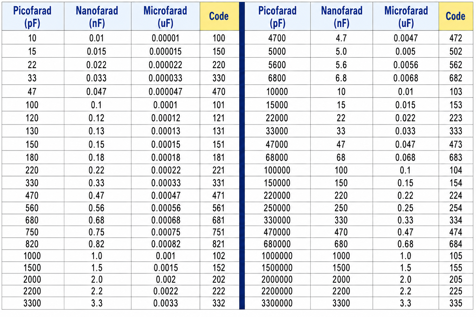

Capacitors come in many different sizes and materials, and some can be surprisingly large. You can learn more about them by going back to the Guides Page and reviewing the Beginners Guide to Components. This document is older and fairly extensive, but it contains a lot of valuable information. For now, you can go directly to the Capacitors section and concentrate on the information you will need for pedal building.
For example, if a capacitor in the BOM calls for a value in pF, which stands for picofarad, it will typically be one of the small orange ceramic disc capacitors. Most builds will have one or more of these. You can also identify them by looking at the PCB silkscreen, since the component outline will be a smaller box. This outline represents the part footprint and shows you the physical size and lead spacing the PCB was designed for.
Another very common type is the polyester film or box capacitor. Here, you need to pay attention not only to the capacitance value but also to the physical dimensions. The voltage rating can give you a good indication of the size; I generally look for 63V or 100V versions at most. You should also check the specifications or datasheet to make sure the capacitor has a 5mm lead spread. Most of our PCBs use a standard 5mm lead spread for film and box capacitors. You can also find convenient assorted kits containing many of the common values.
Another type you may encounter is MMLC (multilayer monolithic ceramic) capacitors. These are typically inexpensive, commonly available with a 5mm lead spread, and can often be purchased in assorted value kits. They are the yellow capacitors shown in the Beginners Pedal Building Guide. These can be used in place of polyester film or box-type capacitors as well as many of the pF (picofarad) values though you will need to pre-bend the 5mm leads to fit. When purchasing be sure they are specifically MMLC (multilayer monolithic ceramic) capacitors and never use Tantalum capacitors which are polarized and must be installed in the correct orientation.
When you see a capacitor in the BOM with a uF (microfarad) value, it will typically be an electrolytic capacitor. These are polarized, so they must be installed in the correct orientation. The capacitor itself will have polarity markings, and the PCB silkscreen will show a + next to the appropriate pad. Always pay attention to both.
You also need to consider the capacitor’s voltage rating. For these pedal builds, I typically use 25V to 63V electrolytic capacitors. Avoid using capacitors rated below 18V, since some pedal builders use 12V or 18V power supplies on circuits that can safely accommodate the higher voltage in order to gain additional headroom. Using a capacitor with too low a voltage rating can cause it to fail if the voltage across it exceeds its rating. Always check the component specifications or datasheet when you’re unsure. You can refer back to the Beginners Guide to Components for more information. You may also find assorted electrolytic capacitor kits, but these can be harder to find in the smaller sizes commonly used in pedal builds. Pay attention to the physical size and lead spacing as well. The electrolytic footprints used on our PCBs are typically 5mm or 6.3mm in diameter with 2.5mm lead spacing, depending on the component. Always check the PCB silkscreen and the component specifications before ordering to make sure the capacitor will physically fit the footprint. There are a decent amount of usable ones in this KIT but 10v are useless in pedals. 16v are fine as long as you stick with a 9v power supply.
The one exception to the uF = electrolytic rule could be a value such as 1uF. A 1uF capacitor may be an electrolytic, but it can also be a film, box, or MMLC capacitor depending on the circuit. The PCB silkscreen can help you identify which type is required: box/film capacitors generally have a rectangular footprint, while electrolytic capacitors have a circular footprint and a + marking for polarity. Always check the BOM and PCB before purchasing the part.
