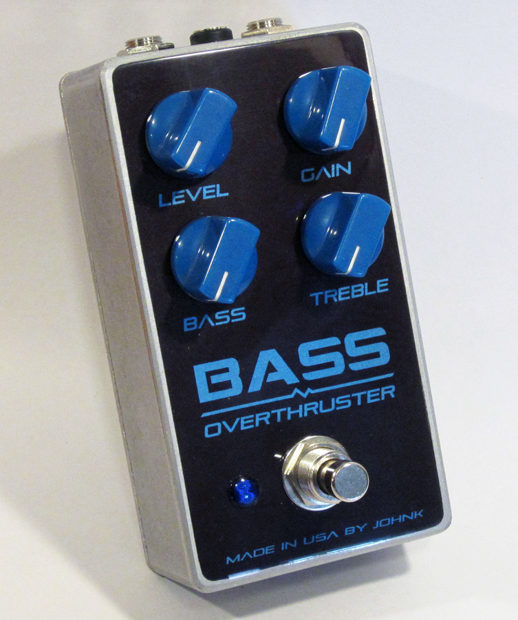

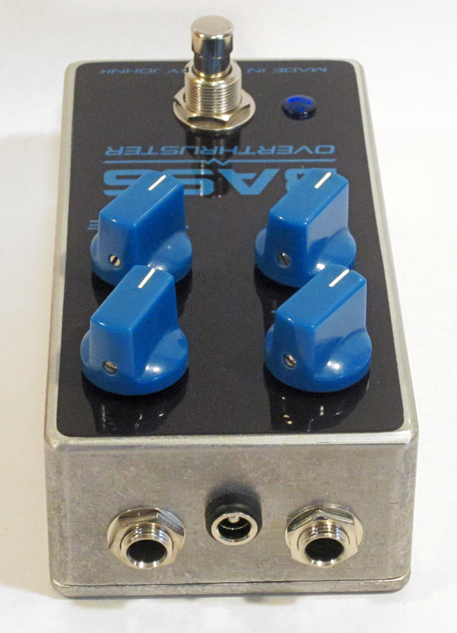

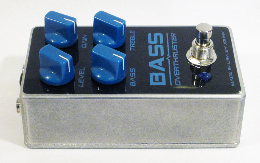

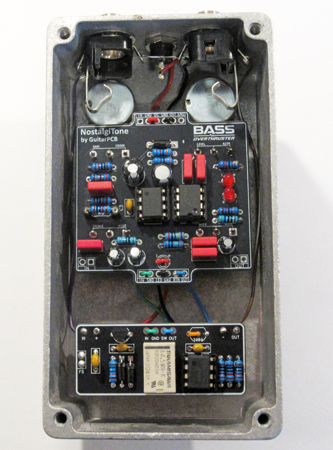

    just finished mounting it in an enclosure with a relayed true bypass. the strange thing is, on some extreme settings it’s still pulsing in & out (and that’s with a 10K for R6!) but i’m done with it,so I’m leaving it like it is.
    pics of the build below:

    just for the heck of it, i just tried replacing the TL072 with an OPA2134 and it’s no longer cutting in and out on any setting (YAY!). and that’s with an 8K2 resistor for R6, so I’m much happier with it now.
    i also have a Powerstage pcb which is nearly the identical circuit so i think i’ll use an OPA2134 in it too.
