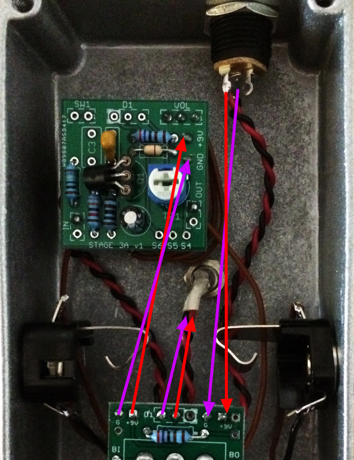

    So I built a few of these up for sale and it just sounds so great for my particular use.
    I love this pedal at the very end of the chain. It just makes everything sound amazingly more pronounced and clear while retaining the character of the pedal I am using it in tandem with.
    Take notice in the build below that I use the symmetrically placed “Dual Power and Ground connections” of our newer v5 version of the 3PDT Wiring board in a manner that provides for a very simple connection from Power supply to 3PDT. It then powers the LED and then I use the other side of the 3PDT to run my Power and Ground to the Main Board. Neat, tidy and secure!
    #12243
    Hopefully it is simple to see above with the added Image how easy and neat wiring can be using the 3PDT wiring board.
