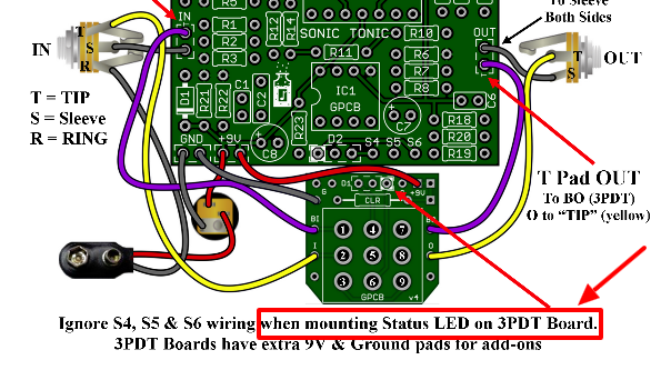

Since you wired the LED to the MAIN Board and not the 3PDT Wiring board it still needs a S3, S4 & S5 connection. You will have to make contact over top the wiring board after you figure the Audio issue.

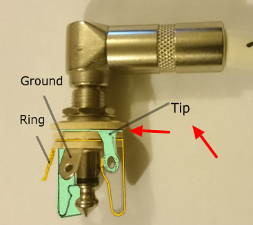

BillyModeratorInsert a jack into your jack socket and follow it round to the solder lugs to make sure your wires go to the correct 3PDT lugs
If you insert a jack like below you can physically see what the tip of the jack connects to on the socket and then follow it round to it’s solder lug as Barry says it is difficult to see in both your builds if you have the IN jack tip wire from the 3PDT connected to the ground solder lug on the socket

BarryKeymasterRight since you have no resistor you will have to carefully tack solder the 3 wires then and connect them to the 3PDT Wiring board as illustrated. Also to avoid confusion you already used the CLR resistor on the Main Board. The reason the wire for S4, S5 and S6 are not shown on your diagram is because you did not use the 3PDT Wiring Board for your LED.
Because you mount the LED to the Main Board you have to do this!

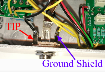

Did you fix this Output Jack?
Since the Output Jack was wired incorrectly the Input Jack may likely be wrong as well.
You will need to verify the Input Jack.
The Tip and The Ring are not always exactly the same on every brand of Jack. You must look closely at the connection on the side of the JACK.
