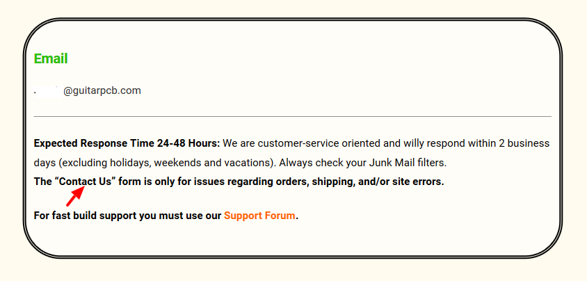

Also to be clear to anyone reading this, PM’s are for order issues. All build questions need to be posted in the forum as I am not always available to answer PMs personally because I am working.
Below is a Photo of the Contact Me form when submitting questions:
