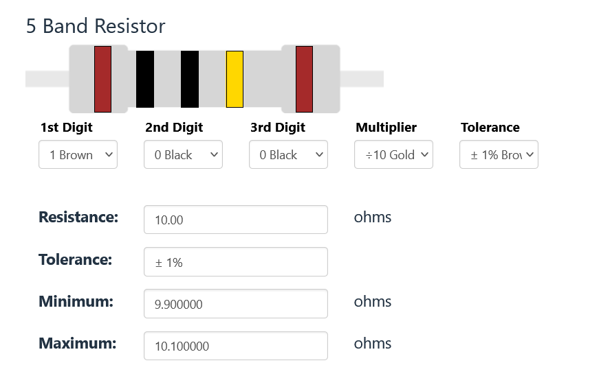

Your Source for DIY Pedal PCBs and NostalgiTone! › GuitarPCB Forum › GuitarPCB Build Support › The vibes v4 2021 r31 Tagged: Resistance r31 vibe v4 This topic has 6 replies, 2 voices, and was last updated 1 year, 7 months ago by Barry. Viewing 7 posts - 1 through 7 (of 7 total) Author Posts October 6, 2024 at 11:31 am #33942 AnonymousGuest In the the vibe v2 2021 how value r31 ,10 ohms or 1m ohm Thank you October 6, 2024 at 1:46 pm #33943 BarryKeymaster R’ represents Ohms, so when you see 10R, it means 10 ohms. ‘K’ stands for kilo-ohms, which equals 1,000 ohms (e.g., 4.7K = 4,700 ohms). Similarly, ‘M’ denotes mega-ohms, representing 1,000,000 ohms. For instance, 1M means 1,000,000 ohms. October 6, 2024 at 2:56 pm #33944 AnonymousGuest Thank you, But in the photo the color band is brown black black yellow and gold In the shematic r10 is good value Sorry for my english i from montreal October 6, 2024 at 3:00 pm #33945 BarryKeymaster It is power filtering only. There is hardly a difference between 10R and 100R. Follow schematic or BOM only. I will check if my photo has an error. October 6, 2024 at 3:06 pm #33946 BarryKeymaster Photo: Gold is hard to represent as a color. That is why there is a 10R label on the resistor. October 6, 2024 at 3:11 pm #33947 AnonymousGuest Yes, thank you, The good is 10R or 100r .ok October 6, 2024 at 3:12 pm #33948 BarryKeymaster Use 10R if you have it. 100R otherwise, or anything in between. Gold is hard to represent as a color. My gold and the resistor calculator gold are actually the same color. That is why there is a 10R typed on the resistor image. Author Posts Viewing 7 posts - 1 through 7 (of 7 total) You must be logged in to reply to this topic. Log In Username: Password: Keep me signed in Log In
