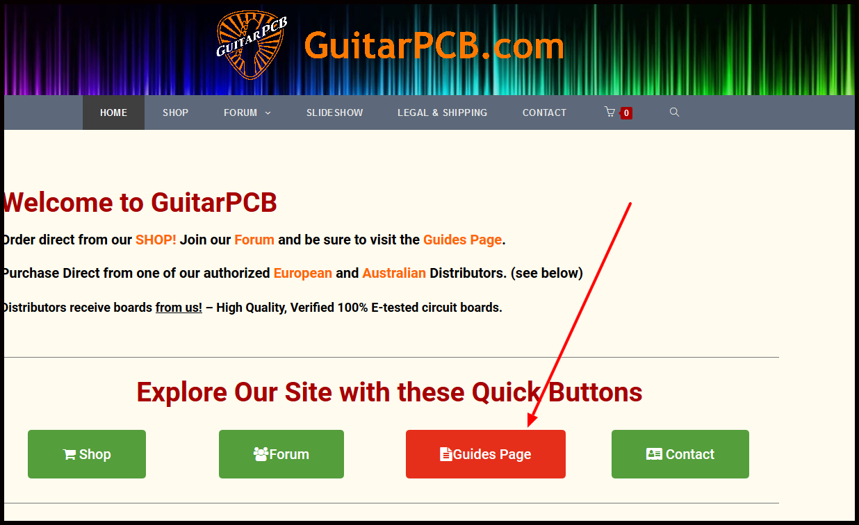

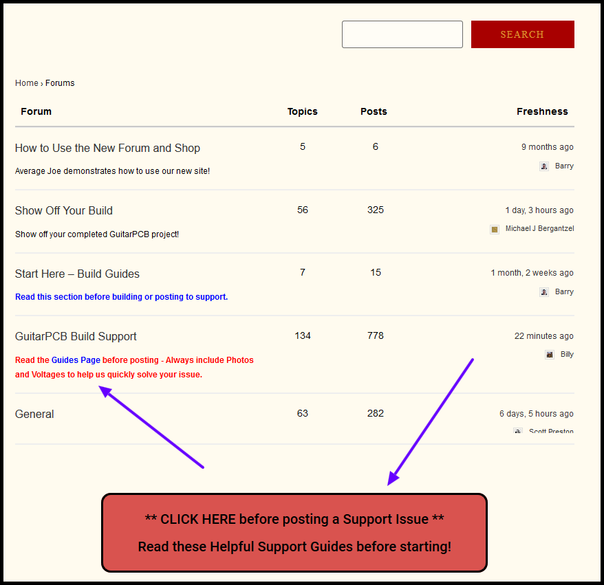

Answer to question about where to find Guidance beyond the basic build document:
See the two images below so you can easily find the Guides Page links:
Image 1:
This one is on the Forum Home Page:
Image 2:
This one is on our Home Page at GuitarPCB.com:
Post a trouble shoot thread and we are glad to help.
