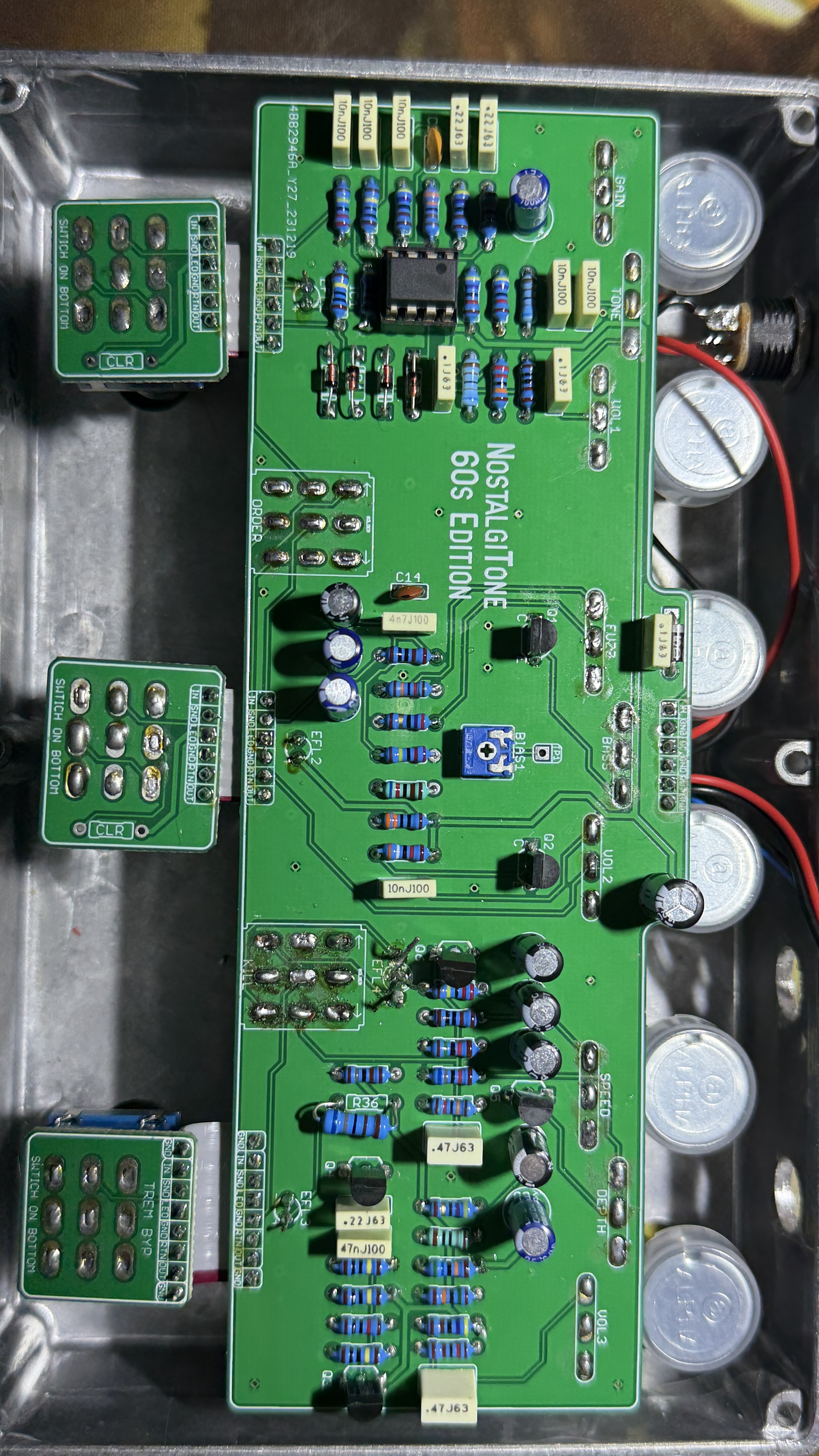

ParticipantOkay, does anyone have any ideas and can help me? I’m completely stuck. I’m not a professional, but I really want to get this working. Basically, I get sound, the tremolo works, the volume is adjustable, the fuzz is incredibly harsh, and the overdrive is producing distortion. None of the LEDs are lit. The tremolo LED worked initially, but the others didn’t. The white LED only works if I reverse the positive and negative terminals at the input. Here’s a picture of my soldering. Danke … Henri
December 4, 2025 at 8:10 pm #37981
PlaysforfunModeratorWelcome Henri. I can’t blame you wanting to get this working. It’s fantastic. You should go ahead and take it apart and fix any backward or blown leds. You are going to need to take the time to reflow all the switch and pot joints. Many look like cold joints that were soldered in haste. You will likely benefit from reflowing the rest of the board as well. As you do, remove the IC first and be super careful around and at the transistors so as not to cook them. Your soldering should result in a lot of shiny mounds shaped more like a hersheys kiss. Barry has a soldering video here someplace. I couldn’t find it just now. Take a look at the Guides Page, though, and scroll down to the guides below near the bottom. Read them all. Good info in there. How did it turn out matching your components up with the examples Jeff24 gave? All good there?
December 4, 2025 at 8:47 pm #37982Anonymous
InactiveThe foot switch soldering looks suspect, there shouldn’t be a depression as the solder leads should poke up through the foot switch board, same goes for potentiometers; no need to trim leads once soldered. Also, you need CLR resistors (on foot switches) for Fuzz and OD. Cheers!

BarryKeymasterI would suggest using some liquid solder FLUX when reflowing along with your solder.
There are many cold solder joints. Also be careful of the iron temperature.
Finally be sure you are using a fine conical tip when doing the small pads above the switch as some of them look like cold joints or limited solder.
For the larger switch pads place a small drop of flux on each pad and reflow the solder. You will not be able to force the switch in any closer but as long as you make a good solder connection you will be fine.
I always apply FLUX to switch lugs before soldering them to PCBs. It just makes everything better.
Most importantly, take your time, and be careful not to burn any solder pads or you will likely need a new PCB.

I already posted a picture of it above… strange. If anyone has any ideas, I’d be grateful.
