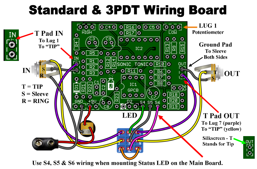

    I bought a Sunn T kit from Das Musikding and got this 3PDT wiring board instead of yours.
    I guess it’s not possible to solder the bi-color LED.
    Can I solder the LED and the CLR on the main board and use this 3PDT wiring board for every other connections?

    I would ask for them to send you a GPCB wiring board so you can do what you want more easily.
    No, you cannot wire a Bi-Color LED to that although you could wire the LED to the Main Board.
    I hope that helps. I would still let them know about the error and why.

    You can hack it to work, with a bi colour LED.
    Using a common anode LED place the anode to the LED+ pad, whatever colour you want in effects mode to the LED –  pad,  add a wire to the other cathode – leg and solder the other end to 3PDT lug 6 the bottom middle lug
    It must be a common anode bi colour LED
    All your actually doing is grounding 1 LED pin or the other to change colour via the switch, so effects colour cathode say green lug 4 connects to ground via lug 5 in effects mode and switched the other way bypass cathode colour say red connects lug 6 to ground
