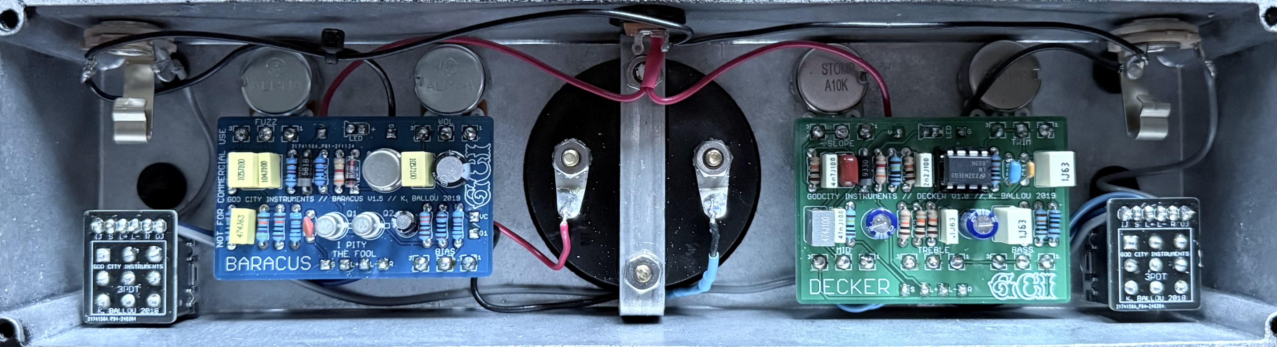

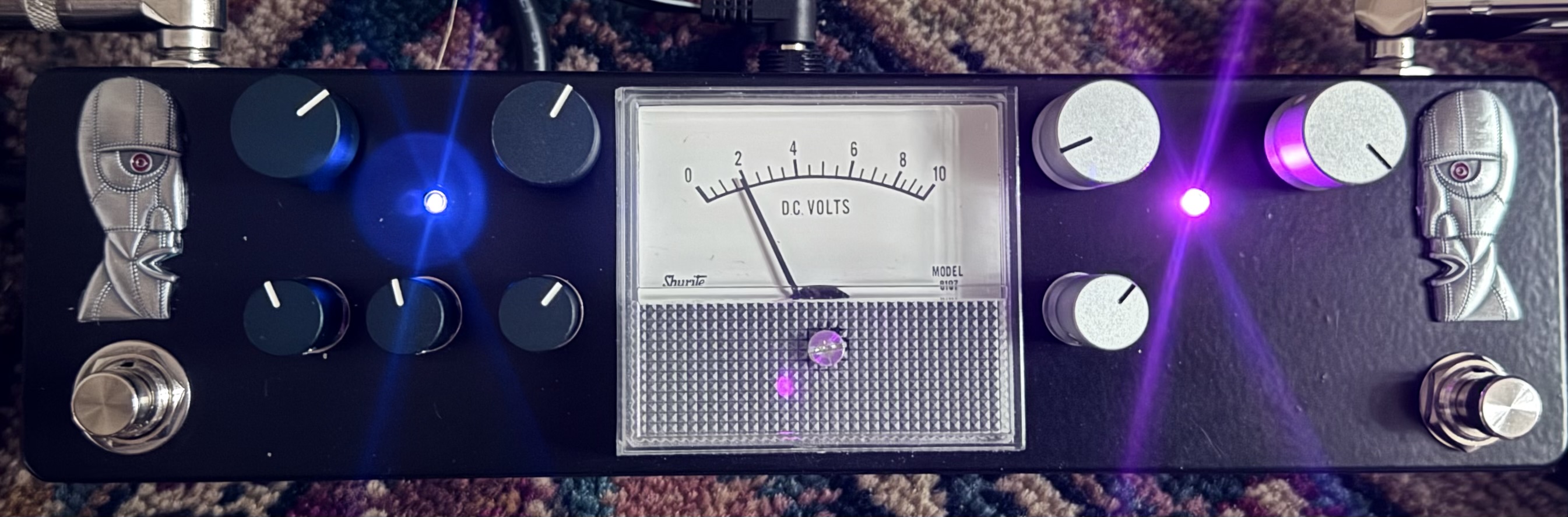

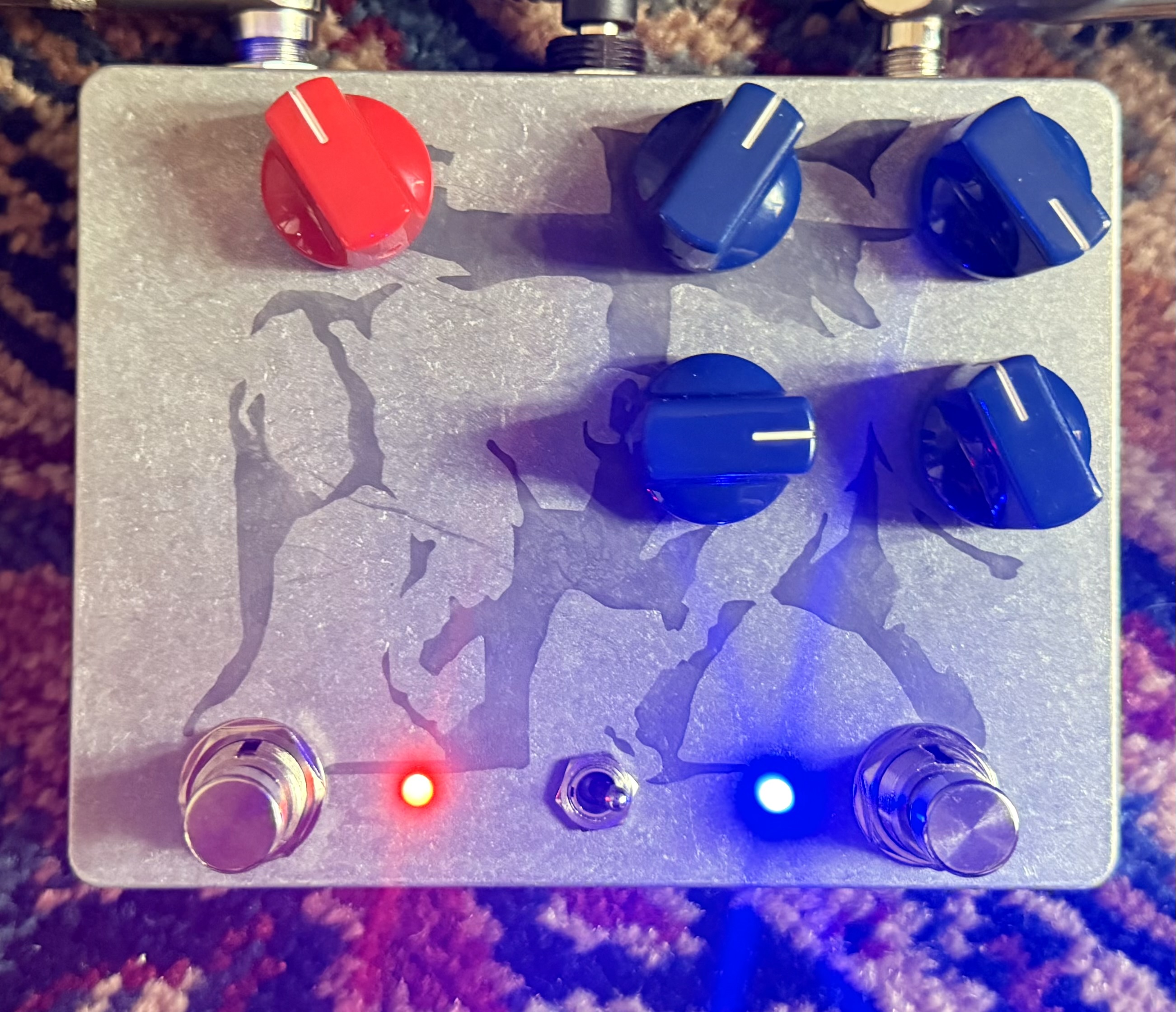

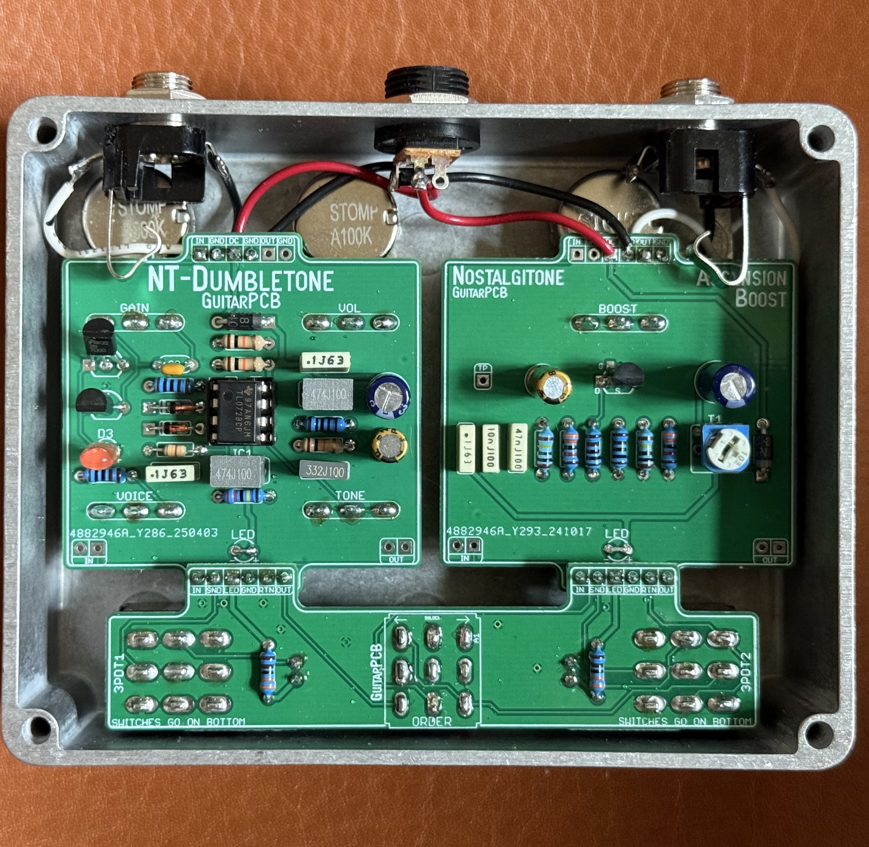

InactiveWhy the elephant? Years ago a musician thought I said, “Dumbo amp”. The Wonderful World of Banksy featuring an elephant with a missile strapped to its back; Hence Dumbletone with an Ascension Boost …
For extra-credit … I finished two combo pedals today! The circuit feature a bias meter for the fuzz and a preamp based on British amps.

InactiveBarry would be the one to ask about that. I bought that meter years ago for a fuzz project and nixed it. I love this meter for bias, because I can dial in to 2V for sweet fuzz and at 4V it makes for usable cackle (anything over or under doesn’t do it for me).The meter is wired to ground with 1k ohm (.994*) resistor and comes off a VC testing pad. I would prefer a less bulky meter for practicality.
* I test every component I install
