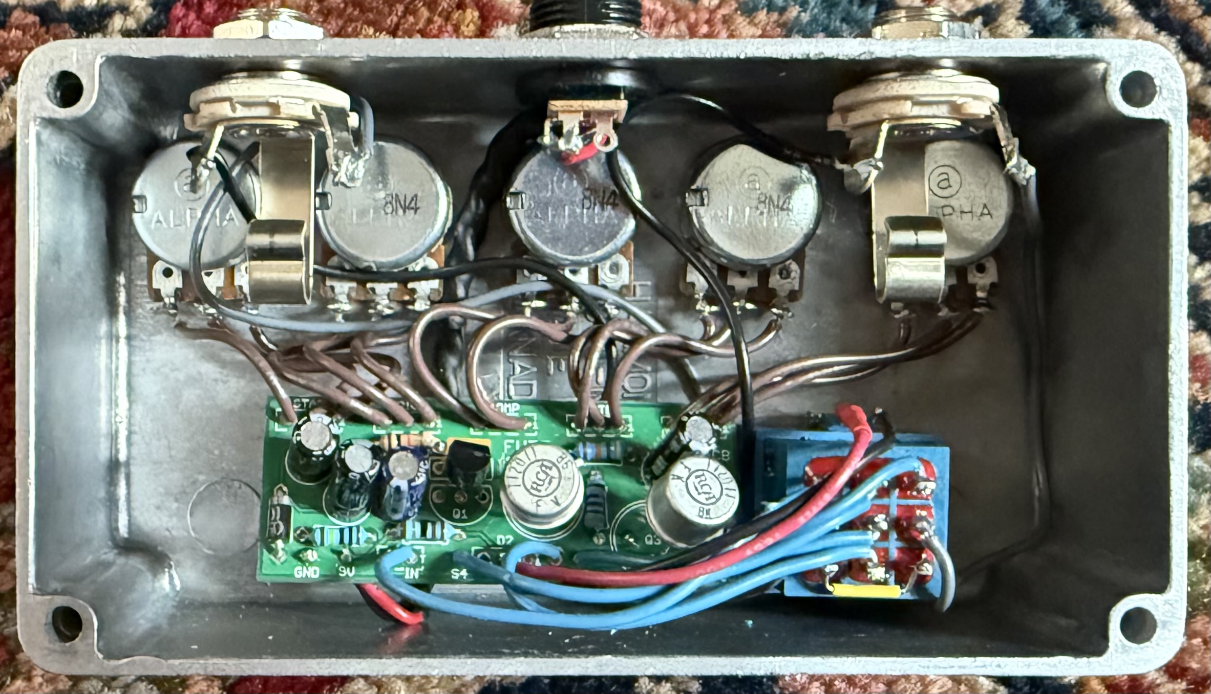

    I found an Industrial Fuzz v3 in a “ I forgot about that” box. I immediately remove Q2 & Q3 sockets, melted one pad and soldered Q3(e) to R4. Shazam it works! Crazy circuit. A variety of fuzz tones, feed back on demand with a roll of the Strats volume, and when I get bored I can turn the guitar volume all the way down and eavesdrop on radio chatter!

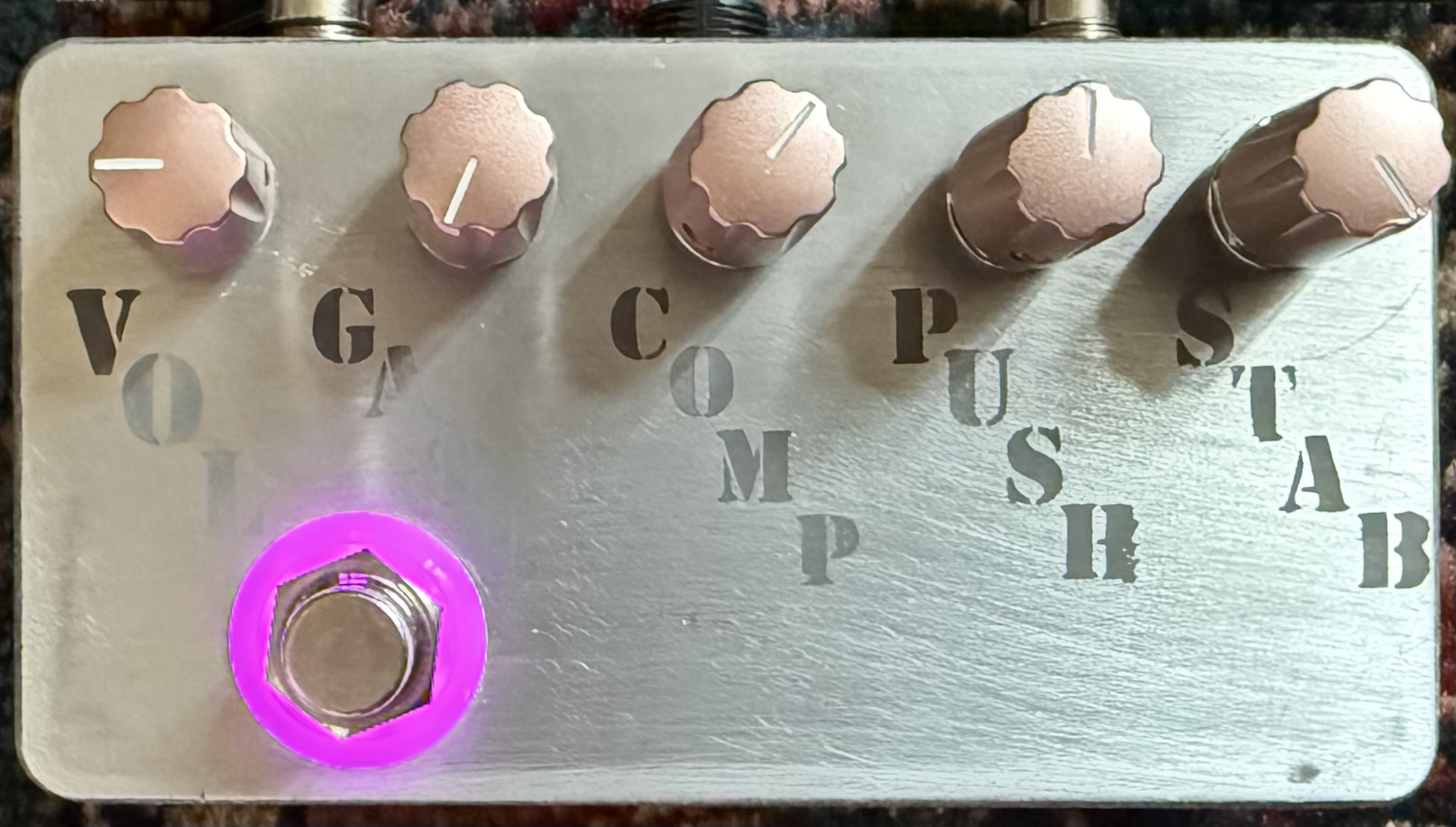

    So far I’ve gotten Fuzz Face, Muff, Superfuzz (aka, Leeds Fuzz), Dirty & Clean Crunch and Massive Wooly Nebulas. Very touch sensitive. The squeal from the Stab is great with a volume pedal & stutter! For the less adventurous … I think an ON/OFF switch for Stab control would turn this pedal into a gotta’ have. Hfe is 81 & 103 RCA PNP House Germ from Small Bear.
    Also, this pedal needs a expression control option for Comp/Gate/Stab. Nice demo!
