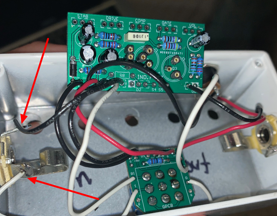

    Hi I’m very new to building pedals and I’m stomped on this 3PDT pub and connecting to my main PCB. Below I have a couple pictures showing how I think it goes. I do need to add a ground wire to my 9v jack. But if anyone could be of any assistance that would be great!

    That looks correct.
    #12819
    Billy
    As Wilkie says looks correct but can’t see all of your IN and OUT jack sockets or the DC Jack it’s hard to see where your red wire goes on the DC jack with the black wire obscuring it
    Just in case here’s how to wire a DC jack although I’m sure you know from the build doc
    And just to make sure on your jacks the ground solder lug is attached directly to the sleeve of the jack socket, the other one obviously being the T for tip connection

    Reverse these two wires.
    See Billy’s post above for why:
