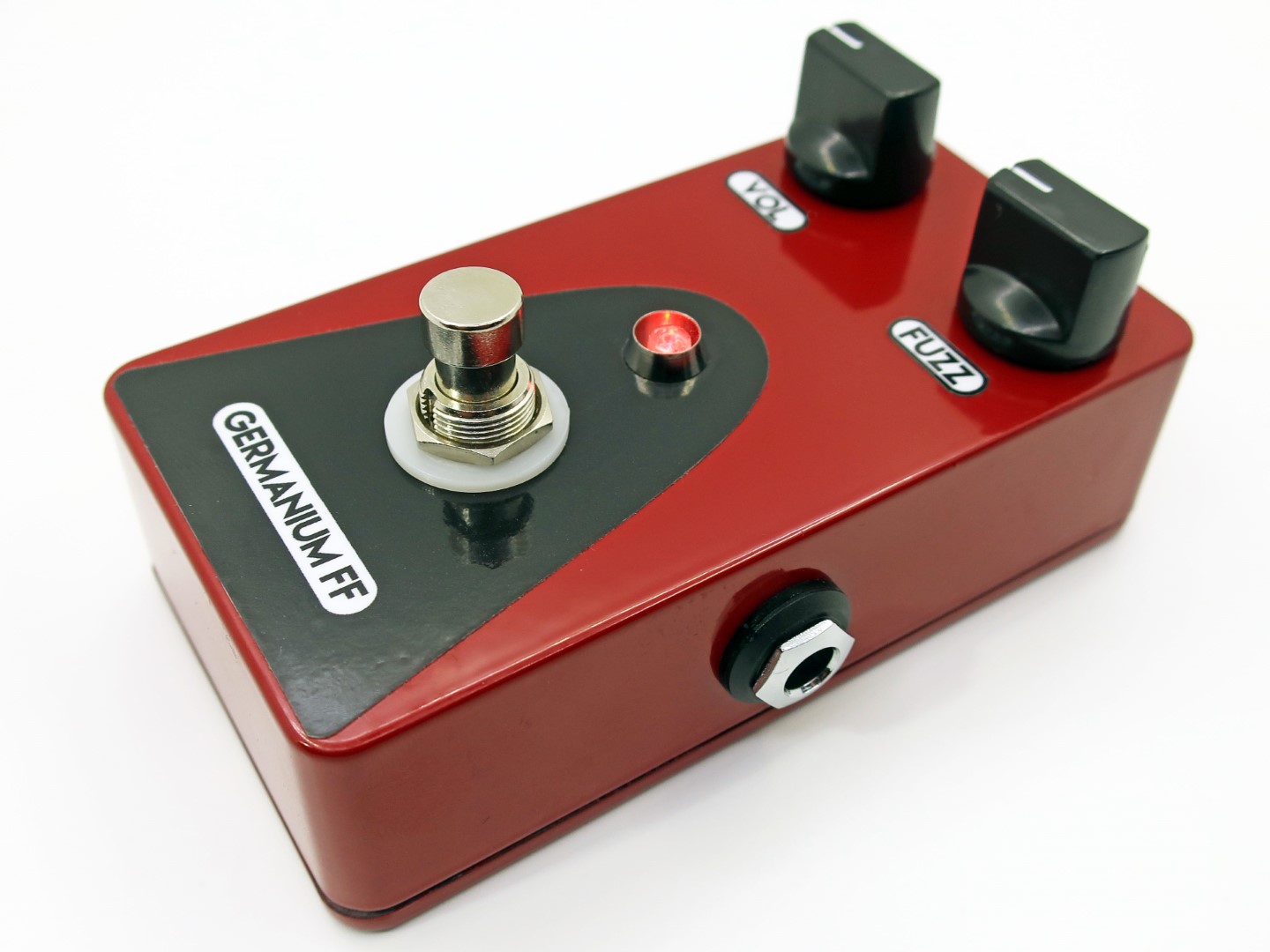

The ElectroSmash Germanium Fuzz Pedal:
Compiling all the knowledge and experience that we have nowadays about the Fuzz Face, we have designed this project that tries to bring the good old classic fuzz tone using modern and controlled technologies:
germanium fuzz by electrosmash
Specifications:
  • NOS Factory sealed Russian Germanium Transistors from the USSR era: with reasonable high-gain (Hfe>60) and super-low leakage current.
  • Turret Board construction on the signal path: timeless vintage construction method; reliable and serviceable.
  • True Bypass: The effect pedal gets completely disconnected from the signal chain once is deactivated.
  • 2 multi-turn Burns trimmer resistors to set the collector voltages on the input and output transistors: Allowing to set the perfect bias for the circuit.
  • 1/2W Carbon composite resistors: Same as the ones used in the original 1966 model.
  • Alpha potentiometers: Using reverse audio for the Fuzz control that gives extra control to the user.
  • Big power supply capacitor (470uF) with low ESR: removes all possible noise from the power supply.
  • Red high-brightness/low current LED that makes the total current consumption of the pedal 2.5mA.
  • Reverse polarity diode:  prevents battery reverse polarity damage.
  • Top quality audio-grade components (2.2uF film input capacitor, Neutrik jacks, Bourn trimmers, Alpha pots, Wurth caps,  axial components, etc)
  • Input jack used as a switch to power the pedal on.
  • Quality PCB:  1.6mm FR4 printed circuit board with plated pads for easy soldering.
The circuit schematic and Bill of Materials are available and open to modifications.

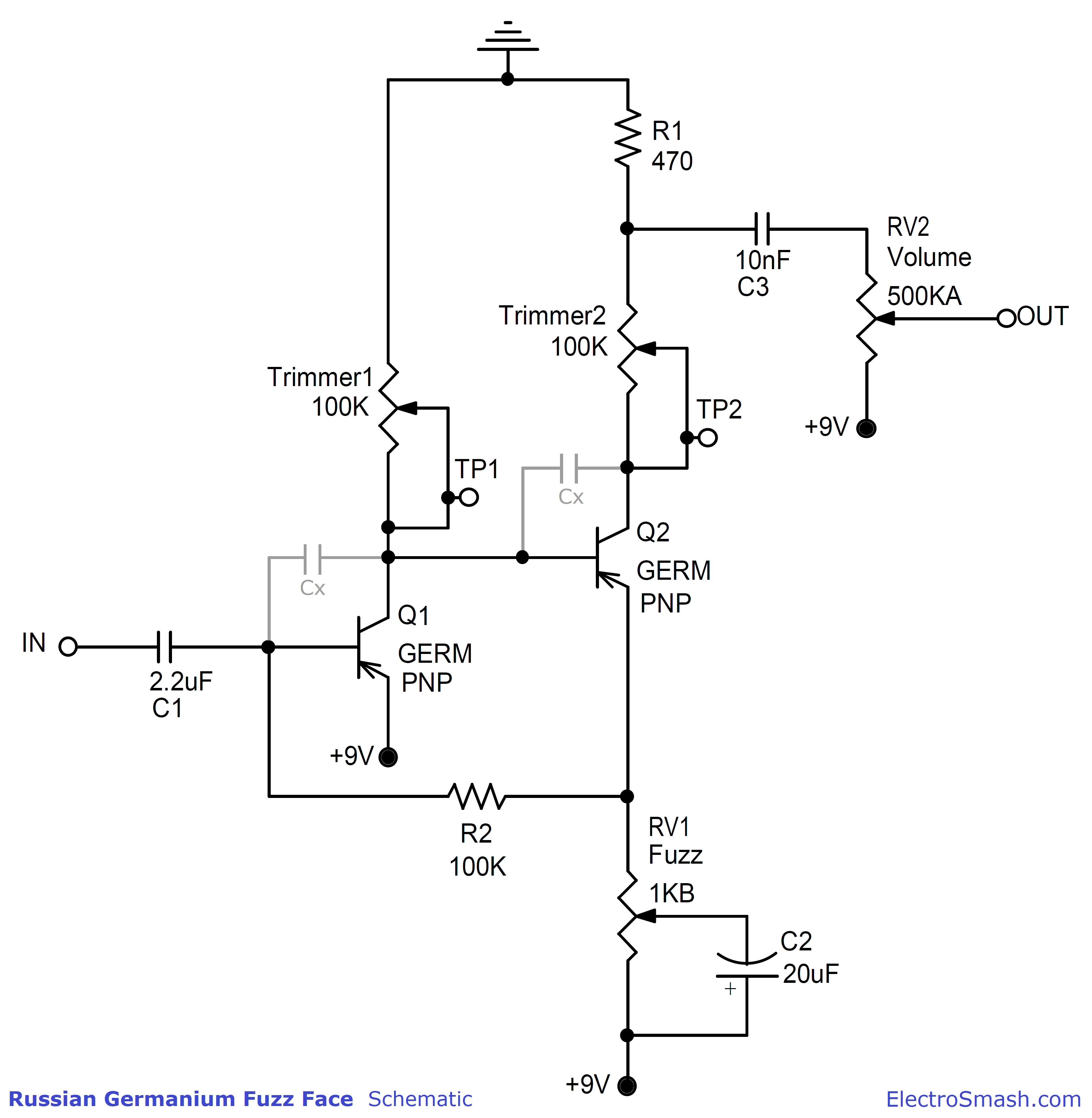

The circuit follows the original Fuzz Face (positive ground) signal path design:
Germanium Fuzz Face Schematic
The pedal uses a double PNP transistor stage and a feedback network. The only two differences with the original circuit are:
  • Two multi-turn resistor trimmers (Trimmer1 and Trimmer2) replace fixed resistors so the bias could be adjusted to the perfect level.
  • Two optional Miller caps (Cx) are included to reduce any possible HF noise.
We ensure that the signal path is the same as in the 1966 FF vintage pedal. All the other features (true bypass, LED, quality components, polarity protection, turrets, power supply capacitor, etc) will not change the sound of it and enhance the quality and performance of the pedal.
If you want to know all the details about the circuit, have a look at the Fuzz Face Analysis.

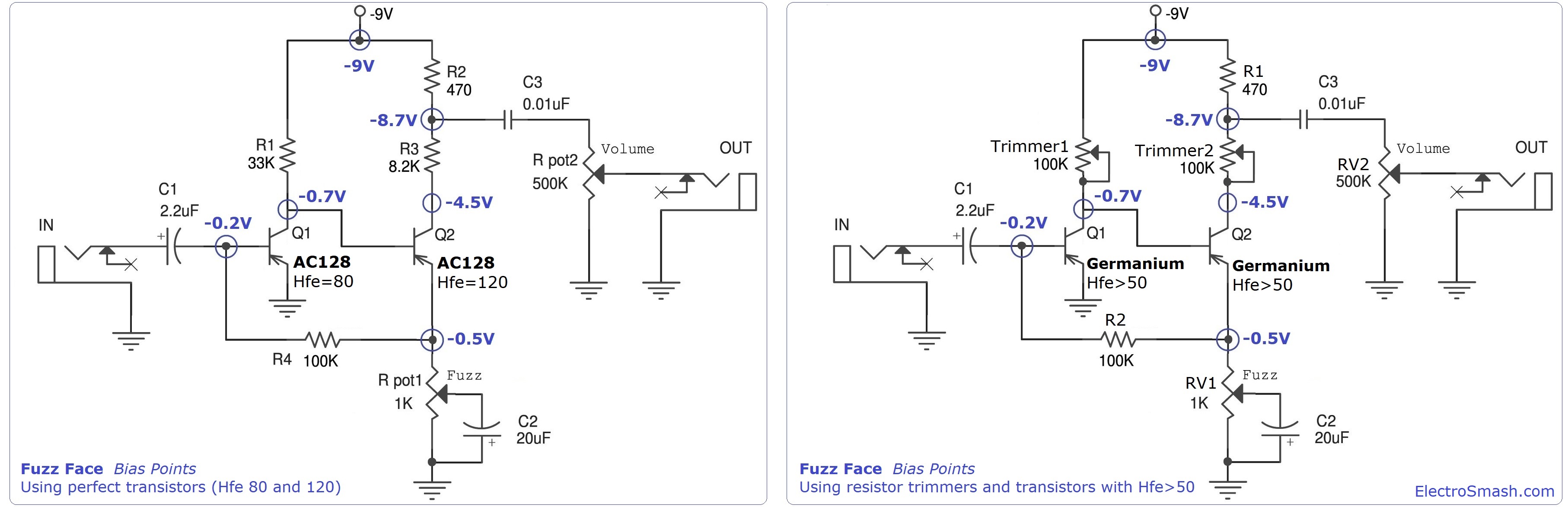

Germanium Transistor Selection – Biasing the Fuzz Face:
It is crucial to select the right transistors in order to archive the best sounding box. Germanium transistors tend to have high leakage current and an inconsistent gain value (Hfe). After years of experimentation and listening, it is agreed that the best match uses a low gain in the first stage (Hfe=80 approx.) and a high gain in the second stage (Hfe=120 approx.). Why is this? well if you use this values, the circuit bias points will look like this:
fuzz face bias
  • Problem: The Original Situation:
On the left image, the most important bias points are VC1=-0.5 to -0.7v and VC2=-4.5V, these values make the effect to sound fantastic. Using a Q1 and Q2 with the gains specified on the left image, the circuit will be biased to that points.
As we mentioned before, theses perfect AC128 120/80 Hfe transistors were long time discontinued. There is no source for them anymore and the only solution for builders is to pay astronomical prices for NOS, to buy big batches of similar transistors and try to find if it any left that meets the requirements, and try to avoid the re-labeled, fakes in that journey.
  • The Solution:
Instead of using the perfect and difficult-to-find transistors to get the circuit biased right, we can use almost any high-gain germanium PNP transistor (Hfe>50) and with the help of 2 trimmer resistors get the circuit perfect biased (right image). By doing this, we will create the same conditions for the transistors as if they were the perfect ones. Dunlop discovers this fact later on and includes a trimmer on VC2 in order to adjust it to -4.5V.

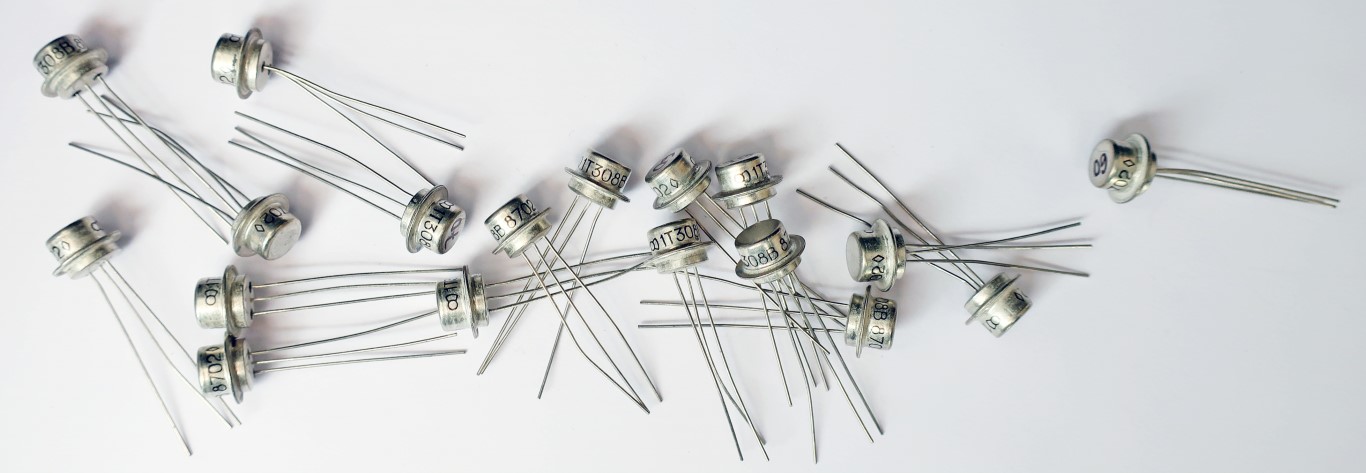

russian germanium transistors
The classic 60’s/70’s soft distortion Fuzz Face pedals (the ones used by Jimi Hendrix) used germanium transistors, but all the parts mentioned above (AC128, NKT275, SFT363E) were a long time ago discontinued. There is no official source of transistors for this pedal anymore, the only way to obtain this parts is using specific online suppliers (Smallbear, etc), eBay, Amazon, repair shops, and surplus outlets.
Russian Germanium Transistors: For this project, we are going to use Germanium PNP transistors. They were manufactured back in the old USSR Soviet days, they are under military specifications that make them good, with a consistent gain and not leaky in current.

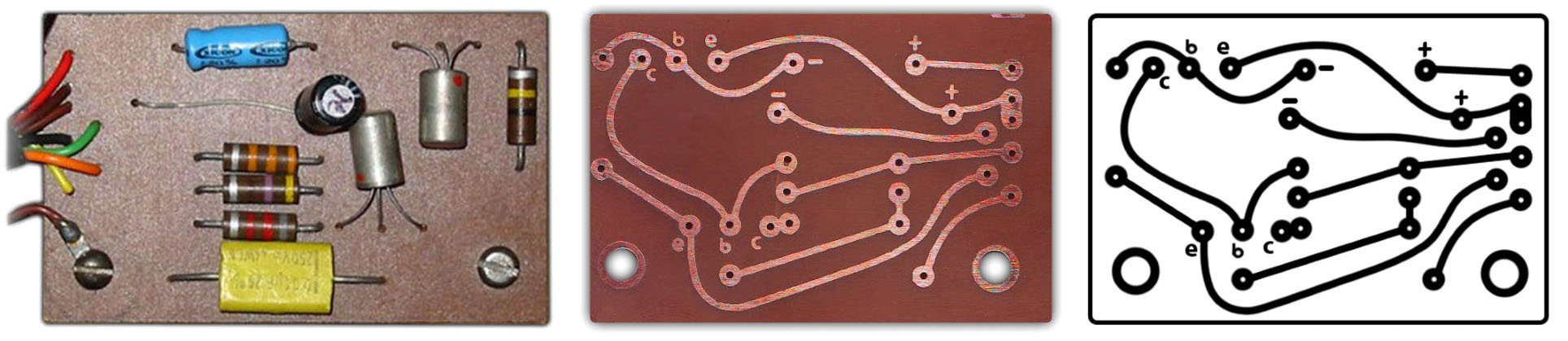

original fuzz face pcb
  • The Fuzz Face Caps: The original FF uses standard aluminum electrolytic capacitors for the 2.2uF and 20uF values and a film for the 10nF cap. They are common technologies still easy to find nowadays.
  • The Fuzz Face Resistors: The original models use 1/2W carbon film resistors. This kind of resistors was extensively used on vintage audio equipment. They are not used anymore because they are considered noisy compared to the modern metal-film resistors. Many people think that original carbon resistors carry part of the organic fuzz distortion sound.
  • The Potentiometers: The 1K linear “Fuzz” pot that was standard issue for the original Fuzz Face. This potentiometer put almost all the action into the last 25% of the rotation. Using a reverse audio pot (instead of linear) will spread out the change in clipping level over much more of the rotation. You get a lot more subtlety of control.
  • The PCB: The original PCB from the 60s uses a single layer printed circuit board, will all the components placed on one side while the tracks run over the bottom. All the pots and jack are soldered to one of the sides of the board. It was the simpler and cheaper way to produce a PCB at that time.
