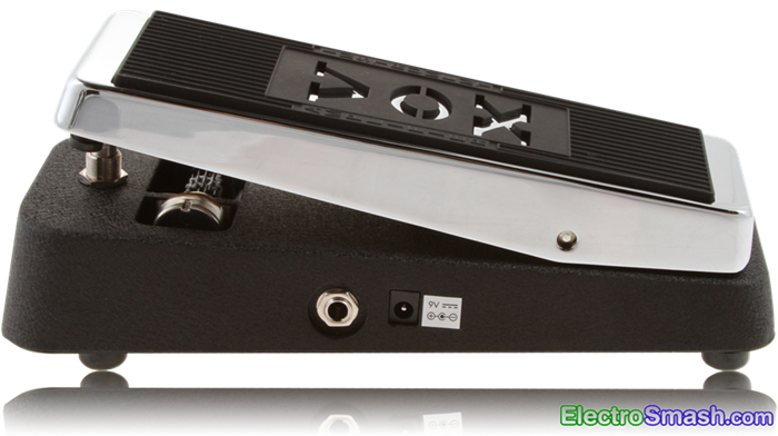

The V847 is a Wah-Wah pedal designed by Lester Kushner and Brad Plunkett and released in 1967 by VOX. It emulates the sound of a trumpet being muted, modifying the guitar tone like a human voice saying the syllable wah.
vox-v847-pedal-small
Vox produced several versions of the Wah-Wah with small circuit adjustments:

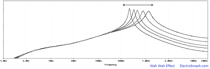

The Wah-Wah effect is basically a tone control. The frequency response of it is a band-pass filter which boosts the resonant frequency and attenuates above and below harmonics. The action of rocketing the pedal shifts the resonant frequency. When the pedal is pushed all the way down, the high frequencies are emphasized, and conversely, when the pedal is all the way up, the bass is boosted.
Wah Wah Effect

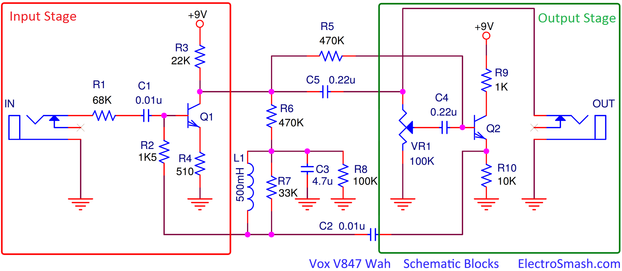

2. The Vox V847 Circuit.
The V847 simple schematic can be broken down into two blocks: Input Stage and Output Stage.
Vox V847 Wah Schematic Blocks
The circuit is built using 2 cascaded transistor stages with a couple of passive components and an inductor; this reduced design makes the power consumption below 1mA.
The gist of the design remains in how the resonant frequency of an LC filter made up of a fixed inductor L1 and a fixed capacitor C2 can be moved using a variable resistor VR1.

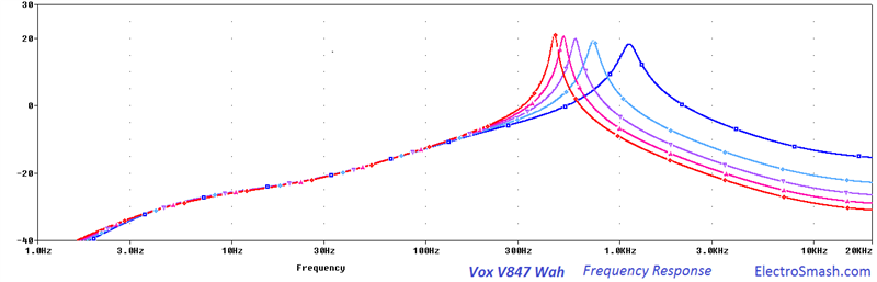

2.1 Vox V847 Wah Frequency Response.
The frequency response is characterized by a resonant peak centered in 750 Hz (pedal in a mid position) and can be swept up and down from 450 Hz to 1.6 KHz. The selected frequencies are amplified up to 18dB while the surrounding ones are attenuated as the below image shows:
Vox V847 Frequency Response

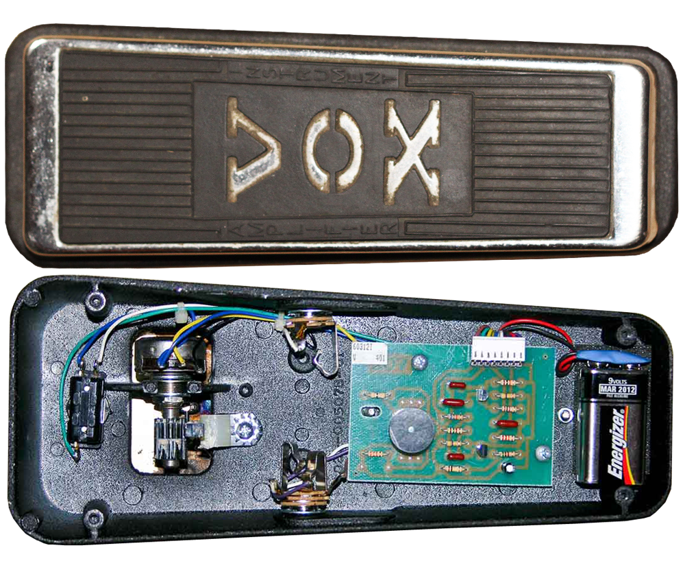

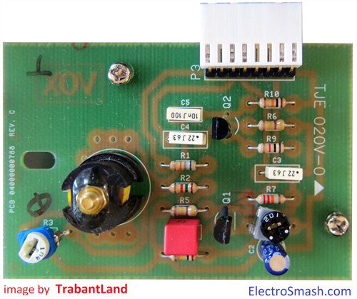

2.2 The Vox V847 Layout.
The printed circuit board is designed to fit without problems inside the big pedal enclosure.
vox-v847-inside-smallThe Vox V847 uses a single layer PCB with insertion components. The side of the board contains a Molex style connector to attach the cables to be connected to the potentiometer, footswitch and jack connectors.Vox V847 PCB

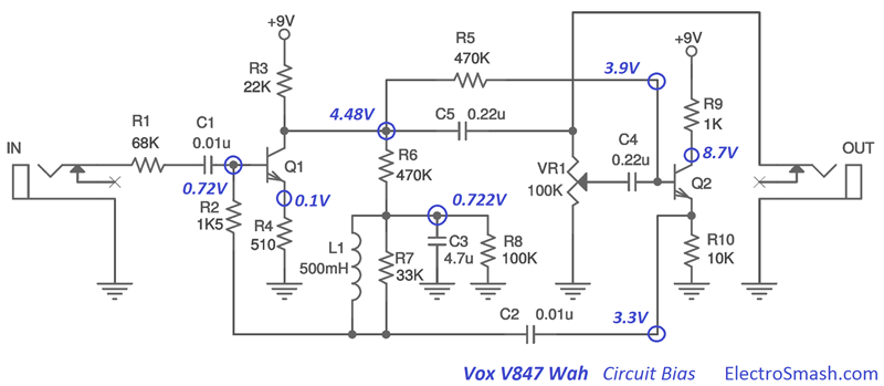

2.3 The Vox V847 Circuit Bias.
In the image below, the most important DC bias points are shown. It can be useful in order to troubleshoot and trace circuit failures:
vox-v847-circuit-bias

3.  V847 Input Stage.
The Input Stage is a Common-Emitter Amplifier with Voltage Shunt Feedback:Vox V847 Input Stage
The input capacitor C1 isolates the guitar from any pedal DC potential, protecting the pickups in case of circuit failure. Resistors R8 and R6 form a voltage divider for determining the bias applied to the base of Q1 through the inductor and resistor R2.
3.1 Input Stage Gain.
In common emitter amps, the approximate voltage gain is collector resistance divided by the emitter resistance (GV = RC/RE = 22K/510 = 43 = 32dB), but the effect of the feedback network has to be taken into consideration, reducing in practice the gain to 18dB.
The feedback network from collector to base is composed by the resistance R6 470K and R8 100K to ground (The inductor in parallel with the resistor R7 33K, can be considered as a shortcut).
This feedback topology is a method to apply negative feedback to the amplifier, while it results in a reduced overall voltage gain and transistor input impedance, a number of improvements are obtained like stabilized voltage gain, improved frequency response and immunity against variations in temperature and transistors Beta.
The measures and simulations indicate that the gain of this stage is around 18dB.
The output of the BJT amp is connected to the 100K potentiometer VR1 in a voltage divider configuration, which means that with the rocketing foot action, the gain of the first stage is regulated, from 18dB to 1dB.

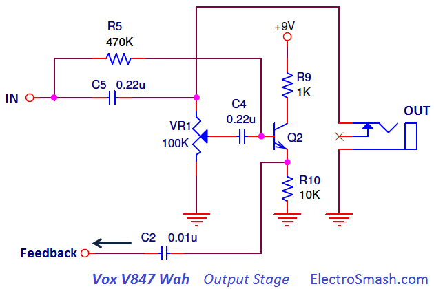

4. Output Stage.
The second stage is an emitter follower working as a low output impedance amplifier of approximately unity gain:
Vox V847 Output Stage
This block will buffer the signal taken from the wiper of the VR1 potentiometer.
  • The bias of the base is obtained from the collector of Q1 through the resistor R5.
  • Resistor R10 is a DC return for the emitter follower.
  • Resistor R9 in the collector is included to suppress the tendency to oscillation.
The output jack of the pedal is taken before the variable resistor VR1 and is not affected by the position of the slider. Therefore, the position of the potentiometer does not affect the output level.

5. How the Wah-Wah works.
The core of the wah design remains in the cap C2 which close the feedback loop between the output (Q2 emitter) and the input stage of the circuit:
The Input Stage amplifies the feedbacked signal coming from the Q2 emitter through C2 and R2.  Because of this amplification of the signal applied across the C2 capacitor, the apparent reactance seen by the input signal looking into the capacitor is different from the real one.
This apparent magnitude of the cap C2 reactance magnitude depends on the gain of the signal of the first stage. The gain of the first stage is determined by the position of the slider VR1:
  • If the slider is set to lower position, Gain = min, Current flow through feedback cap C2 = min, Apparent reactance = max, Apparent capacitance = min.
  • If the slider is set to upper position, Gain = max, Current flow through feedback cap C2 = max, Apparent reactance = min, Apparent capacitance = max.
Connecting a complementary reactance (inductor L1) will produce a resonant circuit which is adjusted by tuning the apparent capacitance of C2.

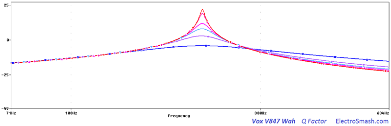

6.1 Modifying the Wah-Wah Q factor.
The Quality Factor is a parameter that characterizes a resonator’s bandwidth relative to its center frequency, that is how narrow or spread is the selected frequency band.
The 33K resistor R7 is introduced to adjust this value, allowing surrounding resonant frequencies to be amplified too. In other words, R7 sets the sharpness of the resonant peak.
Vox V847 Quality Q Factor
In the graph above, the effect of the R7 is shown, increasing its value, the Q factor is reduced, and the filter bell is spread. This modification is also known as “Vocal Mod”,  some users replace the 33K for a bigger one like 39K, 68K or even 100K to have more vocal sounding.

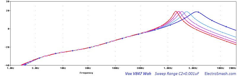

6.2. Modifying the Sweep Range.
The C2 capacitor primary determines the center frequency of the wah sweep. Changing its value moves the whole wah sweep range up or down.
In the images below the shift of the sweep range can be appreciated, using 0.1uF, 0.01uF (default) and 0.001uF.
vox-v847-0.001u-sweep
vox-v847-0.01u-sweep
vox-v847-0.1u-sweep
Bigger values move it down towards bass, smaller values move it up. Bass players like to increase the value (typically 0.068µF) for a better bass wah response.

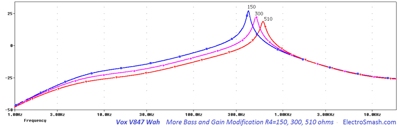

6.3 More Bass and Gain Modification.
The emitter resistor R4 controls the gain level of the effected signal. Reducing its value will result in a slight addition of gain and bass content. In the figure below, it is shown how smaller R4 values modify the frequency response:
vox-v847-more-bass-gain-mod

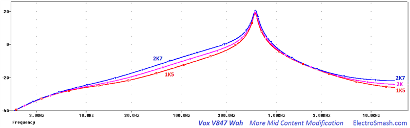

6.4 More Mid Content Modification.
This mod subtle sets the midrange content. Increasing the value of the stock R2 1K5, the heel-down position will sound slightly more strong and emphasized. Typical values for this mod are 2K and 2K7.vox-v847-more-mid-mod

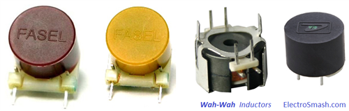

6.5 The V847 Wah-Wah Inductor.
In most classic pedals, there is some component which is often impossible/difficult to find or expensive and it is the one which, of course, gives the best sound or the legendary original tone. In this case the Fasel inductor from the first series
Wah Wah Inductors
There are several options in the market: The Dunlop Yellow/Red Fasel, TDK, Sabbadius Soul Inductor, Coloursound Inductor, Wipple inductor, SOD inductors, miniature audio transformers and coils from industrial filters.
Everything with a DC resistance between 10 to 100Ω (15Ω typ.), and inductance (if you can measure it) between 200mH to 1H (500mH typ.) can be used.
