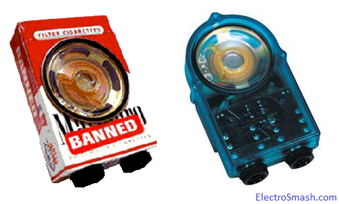

The Smokey Amp is maybe the smallest and most inexpensive guitar mini amplifier, it was made to fit in a cigarette pack and to be powered by a 9V battery.
It was designed by Bruce Zinky, an American Electronic Engineer who headed the Fender amplifier “custom shop”. He developed the simple, clever concept of Smokey Amp in the early 80’s and improved it for production in the 90’s. There are two market models: one in a cigarette pack, and one in a clear molded polycarbonate box.
Smokey Amp by Zinky
The Smokey Amp will also drive any 4, 8 or 16ohm speaker cabinet, including 4x12s, and can even be used on the input of another amp as a fuzz box or booster. There are no controls on the amp, just one input, and one output, meaning that everything is controlled by the guitar volume and tone knobs.
