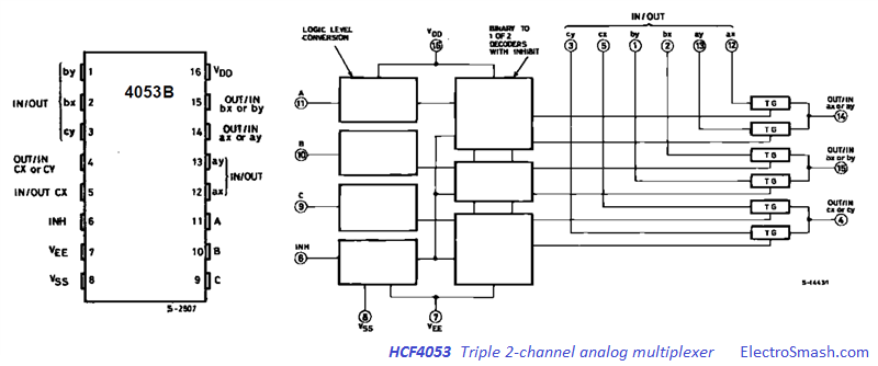

  • The HCF4053 is a triple 2-channel analog multiplexer/demultiplexer: meaning that though three separate digital control inputs (A, B, C and inhibit) a pair of channels are connected. Each channel is attached in a single pole double throw SPDT configuration. It has 2 inputs and 3 outputs although inputs and output are bidirectional.4053 Diagram

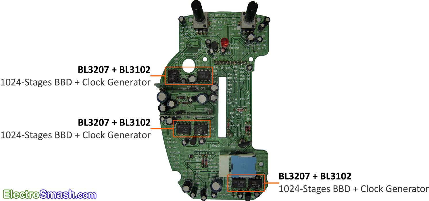

1.3 Mother Board.
It is the main board of the circuit containing a big amount of passive components (Rs + Cs), several transistors, diodes and fifteen ICs: BL3102 x 3, BL3207 x 3, TL074 x 3, PT2399s, TL072 x 2 and 4013B: The Danelectro Sitar Swami creates the oscillating/droning/resonating tones using three Bucket Brigade subsystems (BL3102 + BL3207) and an integrated echo generator (PT2399s).
Sitar Swami Main Board PCB Circuit
Each of the Bucket Brigade Device stages requires pre-post active low pass filtering (anti-aliasing and reconstruction filter), some signal pre-de emphasis, companding, mixing and buffering, for this purpose be three quad op-amp TL074 is used.
Sitar Swami Main PCB Circuit Bottom
  • BL3207: It is a 1024-Stage Bucked Brigade Device manufactured by Shanghai Belling Co, pin compatible with the well-known MN3207 by Matsushita/Panasonic. It is based in N-channel silicon transistors and operates at low voltage from +4V to +10V supply, providing a signal delay adjustable from 2.56ms to 51.2ms with S/N=73dB, THD=0.4% (Vin=0.25Vrms), input clock frequency range from 10 to 200KHz.
BL3207 Diagram
  • BL3102: It is a Clock Generator for the BBD BL3207 manufactured by Shanghai Belling Co, pin compatible with MN3102. Utilizing CMOS technology, with low Voltage Operation from +4V to +10V. It provides the two-phase clock signal and the VGG reference voltage necessary to drive BL3207. The oscillation frequency is easily settled with an external RC network, providing clock frequency ranges from 1KHz to 500KHz.BL3102 Diagram

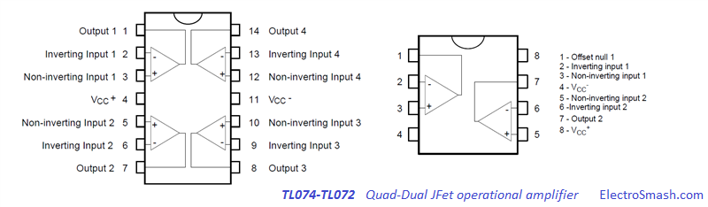

  • TL074: is a Low noise JFET quad operational amplifier by ST Microelectronics. This part has been widely used in stompboxes because of the small footprint that saves tons of space and has low power consumption (low input bias and offset currents). The device is suitable to manage audio signal due to the high slew rate, high input impedance, low offset voltage temperature coefficient and THD (0.01% typ).TL072 TL074 Diagram
  • TL072: JFET Dual operational amplifier. From the same family as the TL074 and sharing similar characteristics but only including 2 op-amps.

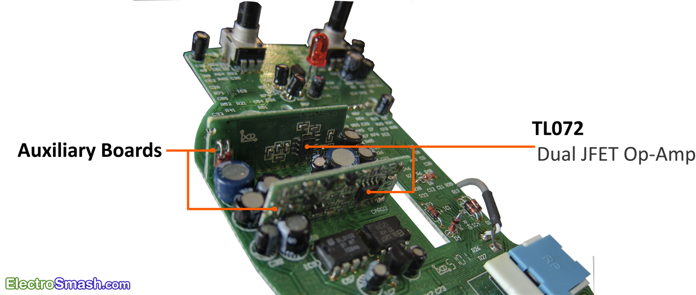

1.4 Auxiliary Boards.
They are two identical PCBs soldered perpendicular to the Mother Board and containing passive components in a symmetric placement.
Sitar Swami Aux PCB Circuits
  • TL072c x 4 JFET Dual operational amplifier: Each of the Auxiliary Boards contain two TL072 chips.
