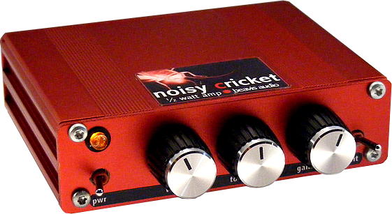

The Noisy Cricket by BeavisAudioResearch is a 1/2W guitar amplifier based on JRC/LM386 chip. It is an evolution of the Ruby Amp by Runoffgroove, keeping the circuit core idea and introducing new features like a tone control and an overdrive boost switch.

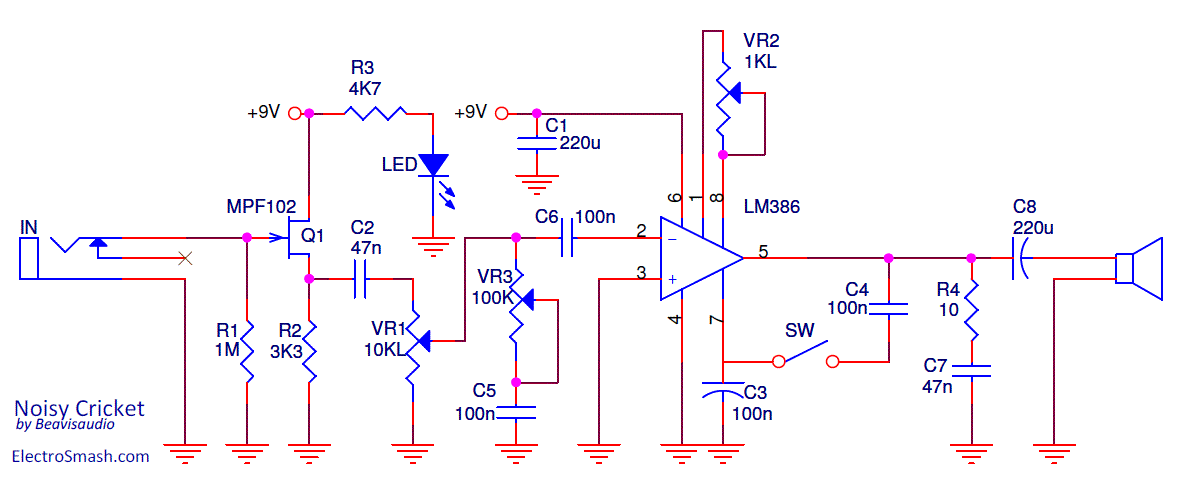

1. Noisy Cricket Schematic Diagram.
The Noisy Cricket circuit keeps the basic configuration of the previous Ruby Amp:
  • A similar Jack Orman Input Buffer.
  • Same Gain setting (VR2), Zobel network(R4, C7), Output Cap (C8) and Stabilization Techniques.
The improvements by BeavisAudioResearch are the boost switch also called “Grit mod” (SW) and a new tone circuit (VR3, C5).

1.1 Noisy Cricket Input Buffer
The Input Buffer is a unity gain JFET common drain transistor amplifier, inspired by Jack Orman designs.
It prevents loading by presenting a high input impedance, avoiding tone-sucking (degraded high harmonics).Noisy Cricket Input Buffer
  • The input impedance of the Noisy Cricket is determined by the value of R1, so it is 1M. The value of R2 is not too critical and may be any value from 3.3k to 10k without much change in the tone. It is better to use lower values since this allows more drive on the negative portion of the audio cycle where the only pull-down is the source resistor.
  • The output impedance of the buffer will depend on the Jfet but is on the order of a few hundred ohms.
1.2 Noisy Cricket Gain Circuit
The 1K logarithmic potentiometer (VR2) is placed between pins 1 and 8 to adjust the voltage gain from 41 (28dB) to 200 (46db), similar to the Ruby Amp. The Gain is calculated following the general LM386 formula:
Where Z1-5 and Z1-8 are the impedances between the respective pins. Note that Z1-5 internal resistance is 15K and Z1-8 is 1.35K.

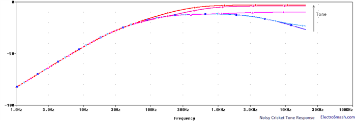

Noisy Cricket Tone Response
As you can see in the above graph, the goal of the tone control is to provide compensatory sonic adjustment, rather than a tonal overhaul. The advantage of this one knob tone circuit is its simplicity but there are also some cons:
  • The volume & tone pots are slightly interactive.
  • The response of the circuit is limited to some values of the tone pot, meaning that only some range of the tone pot will produce a change in frequency response: “I have the tone pot in mine and in fact it does very little for most of the pots’ rotation then at the end some of the upper frequencies are attenuated […]” by captntasty in DIYstompboxes.

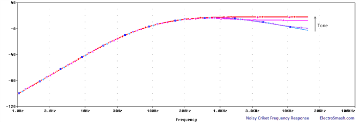

2. Noisy Cricket Frequency Response.
The frequency response is tailored by the Bass Cut filter formed by the output cap C8 and the load (speaker) and the filters of the Volume/Tone circuit previously seen:
The Tone/Volume circuit together with the bass-cut filter (C8) create a subtle mid-hump which means that the circuit accentuates frequencies between the bass and treble ranges (mid-frequencies). A lot of well know overdrive pedals also use this mid-hump equalization around 1KHz to keep the guitar sound from getting lost in the overall mix of the band (TubeScreamer mid-hump is around 720Hz).
This frequency response is also very interesting if you are intended to drive a small speaker because they have a better behaviour when reproducing a small range of frequencies. The low amount of bass keeps the speaker away from farting out and the smooth treble makes the tone less shrill.

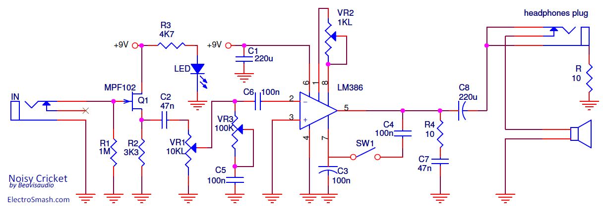

Output Headphone Plug: The solution is similar to the RunoffGroove Ruby Headphone Mod, to place an auxiliary output headphone plug wired as in the image:
Noisy Cricket Headphones Mod Schematic
The resistor R is used to attenuate the output level, otherwise, it will be too loud. The reference value for this resistor is 10Ω but it can be adjusted to meet the user taste and headphones sensibility. This resistor is placed from the sleeve of the connector to ground. It is important to use isolating washers for this jack or use a plastic jack to avoid shortcutting the R between two grounds.
Should be mentioned that using a different load (headphones instead of the of 8ohm speaker), the cut-off frequency of the bass cut filter formed by C8 and the load will be slightly shifted down, depending on the headphones impedance + resistor (R) combination. However, this change is about some inappreciable tens of hertz.
