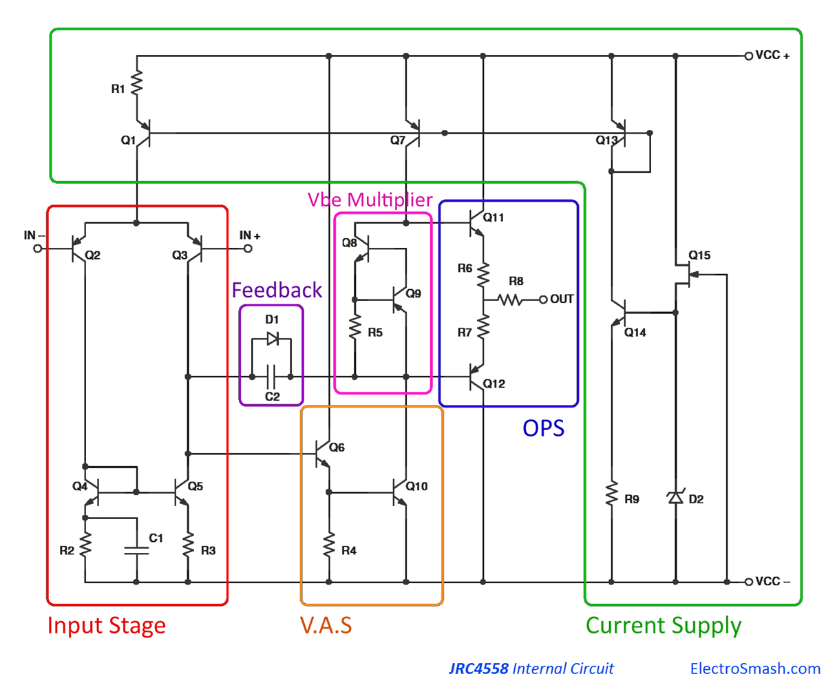

1. JRC4558 Internal Circuit.
The JRC4558 internal schematic is based on the Lin Topology (named after Hung C. ‘Jimmy’ Lin an RCA researcher) following the classic 741 type opamp structure with some modifications. Find below the simplified circuit provided by JRC, broken down into blocks: Current Supply, Input Stage, Voltage Amplifier Stage (VAS), Output Stage (OPS) and Feedback Path.
JRC internal circuit schematic

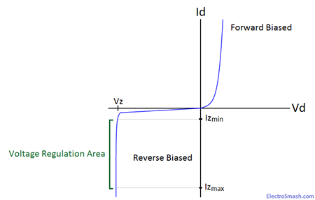

The Zener diode D2, when reverse biased has a constant voltage drop (Vz). As long as the Zener current (Iz) is between certain levels (Izmin and Izmax) called holding current, the voltage across the Zener diode (VZ) will be constantly working in the Voltage Regulation Area:Diode Zener Graph

The input stage is formed by a Long Tailed Pair (LTP) differential amplifier with a current mirror. This stage highlighted in red color is formed by Q1, Q2, Q3, Q4, Q5, R1, R2, R3, and C1:JRC4558 Input Stage1.2.1 JRC4558 Long Tailed Pair Differential Amplifier.
The Long Tail Pair phase inverter or Schmit is formed by a pair of identical and matched PNP transistors in common emitter configuration (Q2 and Q3). The current mirror  Q4  and Q5 in the collector of Q2 and Q3 is the active load of the LTP. This topology is generally the best choice for an operational amplifier, it provides high input impedance, good voltage gain, common noise rejection as well as extra inputs for a summing feedback.

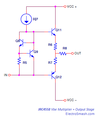

The Output Stage (OPS) is a Class AB push-pull emitter follower amplifier with the bias current set by the Vbe Multiplier. This block is highlighted in blue color and is formed by Q11, Q12, R6, R7, and R8:JRC4558 Vbe multiplier + Output Stage
The function of the Output Stage is to provide enough current gain so that voltage potential provided by VAS can exist over the low load output impedance.
This stage is efficiently driven by the VAS. Variations in the bias with temperature, or between parts with the same type number are common, so crossover distortion and quiescent current may be subject to significant variation. The output range of the JRC4558 is about 1.5 volts less than the supply voltage, owing in part to Vbe of the output transistors Q11 and Q12.
JRC4558 Output Stage
The output resistors  R6, R7 and R8 inserted between output pair emitters also known as ballast resistors, are used to even out differences between internal emitter resistances of transistors, thus their current sharing is improved. The resistor values are usually pretty low,  improving thermal stability, preventing the complementary transistors from directly loading each other and making quiescent current stable.

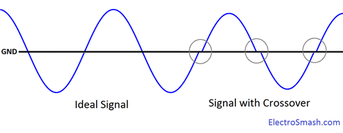

In the output push-pull topology, the transistors Q11 and Q12 do not start conducting until the input signal exceeds their forward voltage, which is the Vbe, typically around ±0.6 V. Counteract is to bias the transistors so that their idling voltage never drops below the forward voltage.
A specific amount of current, known as bias current, is constantly fed to the transistors’  bases in order to ensure that the transistors keep conducting for a desired amount of time, sacrificing the efficiency.

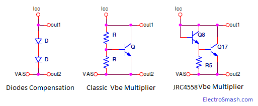

Crossover DistortionThe classic Vbe Multiplier topology consists on one transistor and two resistors. The JRC4558 uses a two transistor approach, a variation from the classic one:
Vbe Multiplier Topologies
The Vbe Multiplier acts as a variable resistor which is mounted to the same silicon device as the output transistors, so they are thermally coupled. Temperature changes of the device affect the gain of the servo transistor; this consequently changes the voltage drop over the Vbe Multiplier circuit.
To improve the temperature coefficient between the Vbe multiplier matching and the output stage. The circuit Vbe Multiplier is equipped with an additional transistor Q8.
