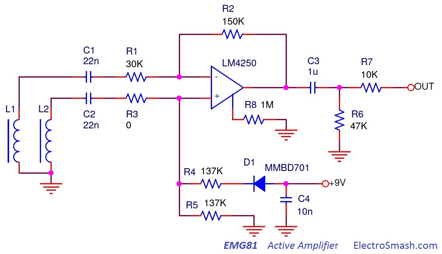

2. EMG81 Schematic.
The EMG81 active pickup circuit is a simple Differential Amplifier:EMG81 Circuit Schematic
A Differential Amplifier amplifies the voltage difference between two coils but it does not amplify the particular single coil voltage (hum common mode). Using an op-amp as a core, the circuit will achieve high differential-mode gain, good input impedance, and low output impedance which reduce pickups loading and tone sucking when connected to the next pedal/amp stage.
  • The Set Current Resistor R8  programs the input bias current, input offset current, quiescent power consumption, slew rate, input noise and the gain-bandwidth product. The 1MΩ value sets the current draw to 80uA for a very long battery life.
  • Diode D1 protects the device against reverse polarity connections.

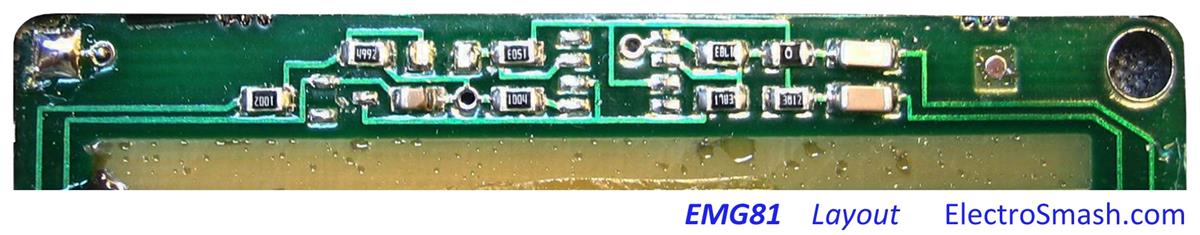

EMG81 layout
The schematic is hard to trace since it is totally encapsulated in epoxy in the baseplate of the EMG81. The circuit is implemented using a single layer PCB, with SMD components.
EMG81 Guts
The coils are wired in a differential mode, so it is close to parallel topology because the output of the two coils is summed together, but they do not interact the way passive parallel coils do, so the DC resistance/inductance is not halved.
2.1 EMG81 Voltage Gain.
The op-amp is labeled as EMG private IC number EMG001, but seems that they are using the National Semiconductors LM4250 part because of its low standby power consumption (500 nW). The design is indeed very close to the datasheet circuit x5 Difference Amplifier.
LM4250 Differential Amplifier
In the classic differential amplifier, the common and differential gain are calculated as:
Making V(+)=V(-):
The two main factors multiplying Vcm and Vd are the common mode gain Gcm (or hum gain) and the Differential Gain Gd (or signal gain):
With this equations, the common-mode rejection ratio (CMRR) can be defined easily.
The CMRR shows the rejection in dB for the hum noise.
In the classic balanced Differential Amplifier topology, the values of the resistors are selected following R1R4=R2R3, simplifying the equations:    (in practice due to component limitations this value can be considered as <-30dB)
Giving a good differential gain (5), good hum voltage gain (0) and maximum CMRR.
In EMG81 circuit is deliberately imbalanced for tone modeling purposes, making R2=0 and R4=R4//R5=68K. Replacing these values in the general equations:
The numbers show that the EMG design will not reject the hum as good as the classic balanced design. This will not make much difference if any to the noise cancelling efficiency, 14.8 dB of hum rejection is still a nice number. As a rule of thumb in audio, 10dB in hum rejection is quite noticeable, 20 dB is very good and 30 dB and above is perfect.
EMG81 Output Impedance
The output impedance is defined by R7, the value is 10K.

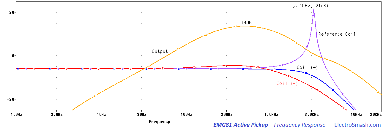

3. EMG-81 Frequency Response.
The peak resonance of a coil is modified (shifted/attenuated/enhanced) depending on the load attached to it. There are several detailed articles explaining how the pickup resonance is altered by the load. The general idea is that lower values of load shift the resonant peak down in frequency, higher values give a much more pronounced resonance at a higher frequency for a brighter sounding pickup.
In the EMG81 circuit, each of the coils sees a different equivalent circuit from their output to ground. These external loads consist of resistance and capacitance from coil outputs to ground.
In passive pickups, the pots in the guitar, cable capacitance, and amp input impedance are an interactive system that modifies the coil response. On active pickups and thanks to the buffering properties of the differential amplifier, the response will be less affected by these factors.
The lack of series resistor in the non-inverting input (+) will shift the fres to higher frequencies, giving a single coil like sound. The coupling capacitors C1 and C2 create a high pass filter in 241Hz. It will additionally remove hum and super bass harmonics.
EMG81 Frequency Response
In the graph above, the signal in each of the coils output is shown in blue/red as well as the circuit output in orange. Unbalancing the differential amplifier is the simplest way to do tone modeling that is to say to move the resonant frequency of each of the coils in a different way to be amplified covering a wider spectrum of frequencies or double resonance. This enrichment will be traded for less hum canceling, but as far as it is below reasonable limits, there is no problem.
With this design topology, it is easy to create multiple humbucker models with distinct tonal signature by just changing some values in the circuit. Using the same PCB and even the same coils in different models.
For this simulation, the equivalent model of a coil is considered as R=4K2, L=5H, and C=500pF. It is shown in the above graph in purple color in isolated response configuration (without any load).
Coil Model

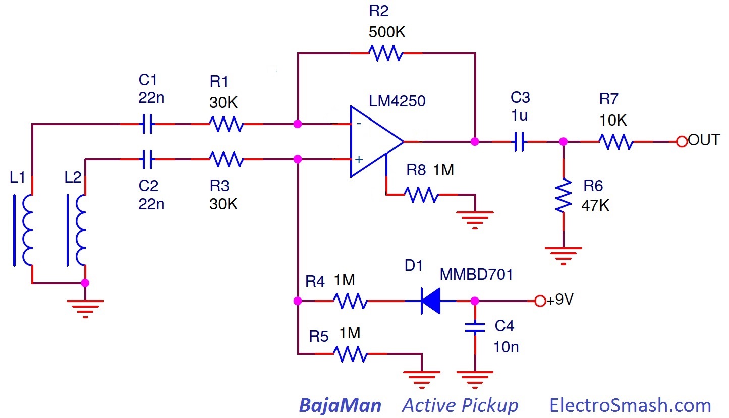

5. Bajaman Active Pickup.

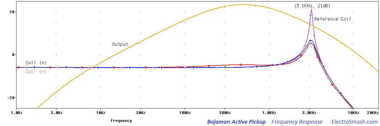

Bajaman proposed a DIY project inspired in EMG81 active circuit. The values of the resistors in the pre-amp are modified in order to create a different tone response. Bajaman designed a balanced differential amplifier with higher bias resistances (R4 and R5) of 1MΩ and feedback resistor R3 of 500KΩ. Bajaman Active Pickup Schematic
  • The coils will be loaded with 500KΩ approx,  giving similar tone as most Gibson pickups used in Les Pauls and 335s which use 500k volume pots. Featuring more brightness because the fresonance will be higher and more pronounced compared to the EMG81.
  • The voltage gain is increased, it is 16 times or 24dB (Gdif=R3/R1), this extra output makes the EMG81 lifeless in comparison. Noise cancellation is better than in EMG81 because of the balanced topology. In the other hand, the double resonance effect pursued by EMG will be lost.

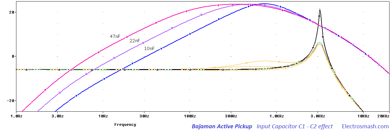

  • Coupling capacitors C1 and C2 can be decreased for more high-end response or increased for more bass:
bajaman-frequency-response-caps
