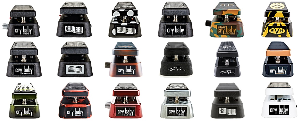

Signature models include: JH-1 Jimi Hendrix, JH-1FW Jimi Hendrix Fuzz Wah, DB-01 Dimebag Darrel, ZW-45 Zakk Wylde, SC-95/SW-95 Slash Signature, EVH Signature, KH-95 Kirk Hammett, JC-95 Jerry Cantrell, etc…
cry-baby-wah-signature-models

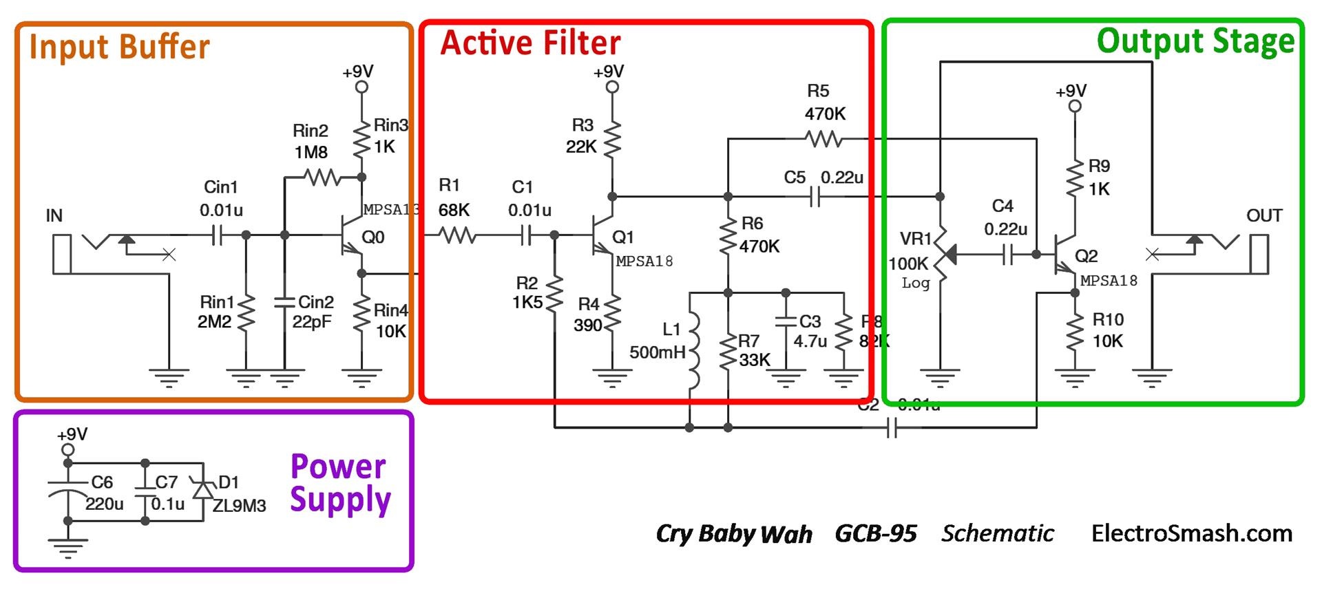

2. The Dunlop Cry Baby GCB-95 Circuit.
The Dunlop Cry Baby GCB-95 schematic can be broken down into four blocks: Power Supply, Input Buffer, Active Filter and Output Stage.cry-baby-wah-gcb-95-schematic-parts-small
The circuit is undoubtedly inspired on the VOX V847. One of the major concerns of the original VOX design was the tone sucking due to the low input impedance of the Input Stage which was 69.5KΩ. Dunlop fixed this problem adding a buffer which raises the input impedance to 1MΩ preserving the guitar original tone. Besides the Input Buffer there are only two changes in the circuit:
  • R4 size is reduced (from 510Ω to 390Ω): creating a slightly higher voltage gain in the Q1 stage.
  • R8 is also reduced (from 100KΩ to 82KΩ): this change just varies a bit the bias of Q1, not affecting the tone at all. It is just a component resource change.
The design is built using 3 cascaded transistor stages with a couple of passive components and an inductor; the simple circuit makes the power consumption below 1mA.
The gist of the design remains in how the resonant frequency of an LC filter made up of a fixed inductor L1 and a fixed capacitor C2 can be changed using a variable resistor VR1.

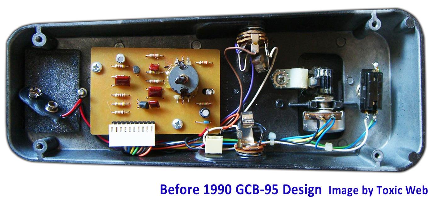

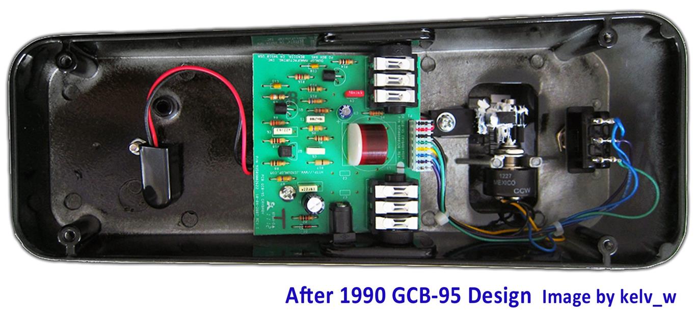

2.1 Dunlop CryBaby Wah GCB-95 Guts / PCB Layout.
Before 1990 all Dunlop Wah pedals had wires between the jacks and the circuit board. In mid-1990 Dunlop changed the PCB design and started mounting the jacks directly on the PCB. Also, from mid-1991 onwards, a buffer circuit was added before the actual wah circuit (it is there if your PCB says ”Rev F” or higher).
cry-baby-wah-gcb-95-guts-before1990
cry-baby-wah-gcb-95-guts-after1990
The current revision looks much like the models that have been running since mid-1992. For more detailed info about the different versions of the circuit you can check the StinkFoot website.dunlop-crybaby-gcb95-pcb
The single layer PCB fits without problems inside the big pedal enclosure using through-hole components.

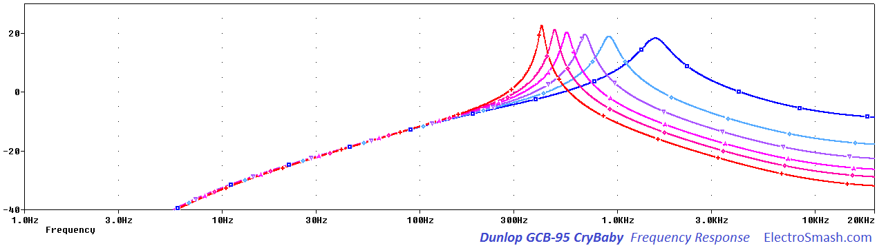

2.2 Dunlop Cry Baby GCB-95 Frequency Response.
The frequency response is characterized by a resonant peak centered in 750 Hz (with the variable resistor VR1 at mid position). The peak sweeps up and down from 450 Hz to 1.6 kHz. The selected frequencies are amplified up to 18dB while the surrounding ones are attenuated:

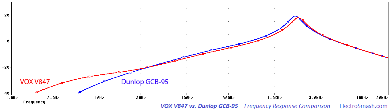

2.3 Dunlop CryBaby GCB-95 VS. VOX V847 Differences.
The circuit of these 2 pedals is pretty similar; the Dunlop design includes the Input Buffer to preserve the signal integrity but the price (Dunlop slightly cheaper), quality construction and sound are really similar. Players often decide between the two of them just on the looks.
Dunlop CryBaby GCB-95 Vs VOX V847 Frequency Response: The crybaby has slightly less bass content. You can check in the graph below how the low freq harmonics are more present in the VOX than in the Dunlop due to the Input Buffer which filters part of this bass content.

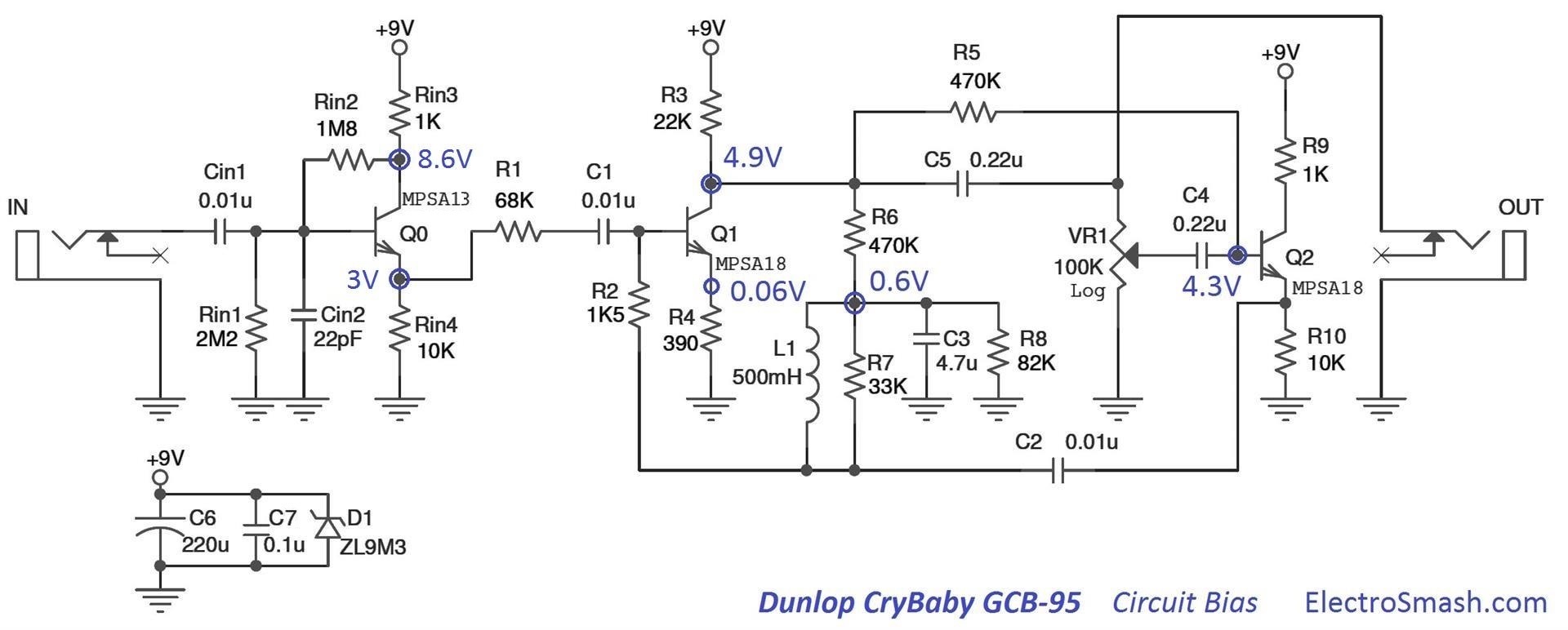

2.4 Dunlop CryBaby GCB-95 Circuit Bias
The most important DC bias points are shown in the image below. It is useful for circuit failure troubleshooting:
dunlop cry baby wah gcb 95 bias

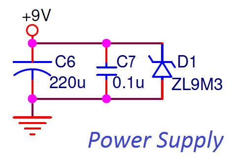

3. Power Supply.
The simple Power Supply Stage provides a stable energy supply to the circuit.cry-baby-wah-gcb-95-power-supply
The 9V supply will feed the transistors. The ZL9M3 is a 9.1 zener diode which helps to regulate the power line (protecting the circuit from voltage peaks over 9.1V) and also prevents reverse polarity connections.
  • Capacitors C6 and C7 between 9V and ground remove noise from the power line.

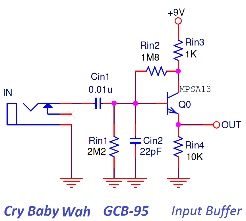

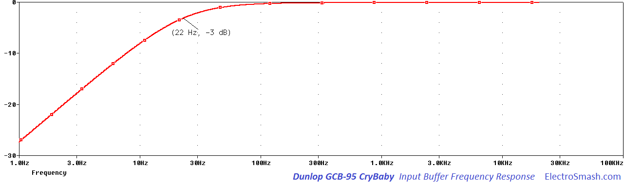

4. Input Buffer.
The first stage is an Emitter Follower / Common Collector NPN amplifier, with unity voltage gain, high input impedance and low output impedance which makes it very suitable for buffering the signal, avoiding high-frequency signal loss:cry-baby-wah-gcb-95-input-buffer
  • The 0.01uF input capacitor Cin1 isolates the guitar from any pedal DC potential, protecting the pickups in case of circuit failure and removing hum.
  • The resistors Rin1 and Rin2 form a voltage divider in order to bias the transistor Q0.
  • Resistor Rin3 in the collector is included to suppress the oscillation tendency.
dunlop-crybaby-gcb95-input-stage-frequency-response
Dunlop Cry Baby GCB-95 Input Impedance:
For simplification we can ignore Rin3, the input impedance is Rin1 in parallel with Rin2 and the input impedance of the emitter follower. It can be calculated following the formula:
1MΩ can be considered a good input impedance to avoid signal degradation. The effect of the resistor Rin3 reduces this value to 750KΩ which is still a good input resistance value.
note: The hybrid-pi model and mathematics behind the Voltage Gain and Input Impedance calculation are similar as in Tube Screamer input buffer, check it for further details.
5. Active Filter.
The Active Filter stage is a Common-Emitter Amplifier with Voltage Shunt Feedback network:
cry-baby-wah-gcb-95-active-filter
  • The C1 is a bypass capacitor that isolates the Input Buffer from the Active filter.
  • The resistor R1 is almost all the input impedance of this Active Filter stage and helps to raise the input impedance of this stage preserving signal integrity.
  • Resistors R6 and R8 form a voltage divider for determining the bias applied to the base of Q1 through the inductor L1 and resistor R2.
Active Filter Voltage Gain.
In Common Emitter amps, the voltage gain is calculated as GV = RC/RE = 22K/390 = 56.4 = 35dB. The effect of the feedback network has to be taken into consideration, reducing in practice the gain to 19dB. The feedback network from collector to base is composed by the resistance R6 470KΩ and R8 82KΩ to ground (The inductor in parallel with the resistor R7 33KΩ, can be considered as a shortcut).
Applying negative feedback in the transistor amplifier results in an overall reduced voltage gain and transistor input impedance with some improvements like stabilized frequency response and immunity against transistor variations.
The output of the Q2 is connected to the 100K VR1 voltage divider, with the rocketing foot action the voltage gain delivered by the Active Filter Stage is regulated, from 19dB to 1dB.

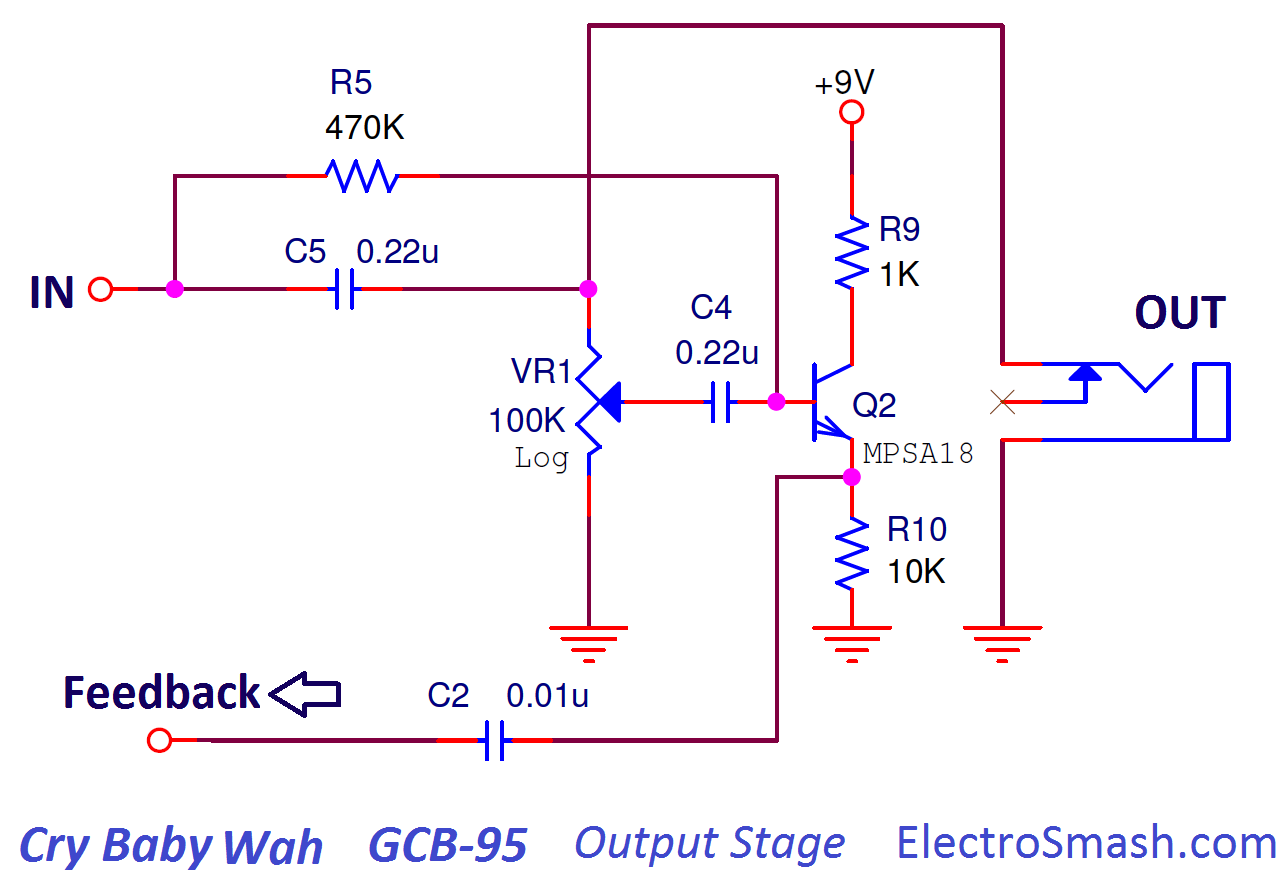

6. Output Stage.
The last stage is an Emitter Follower used as a low output impedance amplifier with approximately unity gain. The topology is almost the same as in the Input Buffer.
cry-baby-wah-gcb-95-output-stage
This block will buffer the signal taken from the wiper of the VR1 potentiometer.
  • The Q2 transistor is biased through the resistor R5.
  • Resistor R10 is a DC return for the Emitter Follower.
  • Resistor R9 in the collector is included to suppress the tendency to oscillation.
The output jack of the pedal is taken before the variable resistor VR1 and is not affected by the position of the foot pedal. The position of the potentiometer does not affect the output volume level.

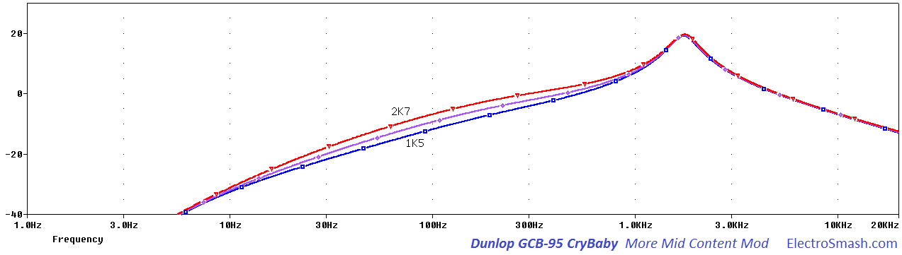

8.5 More Mid Content Modification.
This mod subtle sets the midrange content. Increasing the value of the R2 resistor the heel-down position will sound slightly more strong and emphasized. Typical values for this mod are 2KΩ and 2.7KΩ (default R2 resistor is 1.5KΩ).
