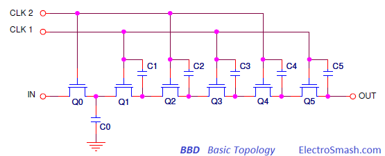

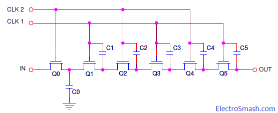

2.1 The Basic Topology.
The basic model invented by Sangster at Philips in 1968. It was the first attempt to make a practical implementation of an analog delay structure. This initial design had a poor transfer efficiency being limited to few stages and low-frequency applications.
Bucket Brigade Basic Topology.

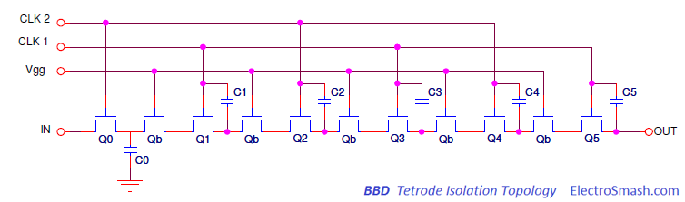

2.2 The Tetrode Isolation Topology.
The first major advance also by Sangster at Reticon Corporation, introduces an isolation of tetrode structure with a DC biased gate NMOS transistor separating each clock element.
Two out of phase clk lines are required: one to govern the even-numbered caps and the other to drive the odd-numbered ones. The performance was enhanced being able to use it in audio applications.Bucket Brigade Devices Tetrode Isolation TopologyBetween each of this switch transistors, there is a capacitor (charge-holding element) which is separated by a DC-biased gate transistor, which greatly improves transfer efficiency. Only half of the caps carry information, the other half remain charged

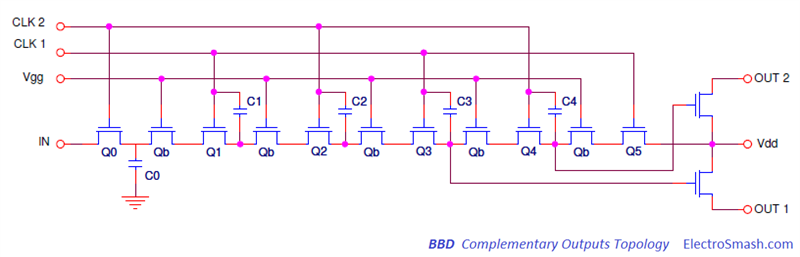

2.3 The Complementary Output Topology.
The output architecture was enhanced using two source follower transistors connected to the last two consecutive capacitors, resulting in a full wave output. Mixing these two outputs a more continuous output waveform is generated, providing a means of improved suppression of clocking glitches.
Bucket Brigade Devices Complementary Outputs TopologySome designs use a trim-pot to vary the load termination between the two output followers to minimize clock frequency component due to VGS between them. This could be useful if running very low clock frequencies, and tight filter skirts to passband.

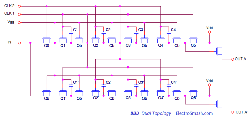

2.4 Dual Topology.
Another well-known topology is the Dual Delay Line which is made of two delay sections running in parallel:
Bucket Brigade Devices Dual Topology
This approach offers flexible performance:
  • Each section can be used independently, only sharing the power supply.
  • Each section can be connected in series to get double delay time for a given sample rate.
  • Each section can be multiplexed to double the sample rate.
  • Each section can be operated in differential mode in order to reduce even harmonic distortion.
  • Several devices can be connected in series.
For more details about these configurations check the Reticon SAD1024 datasheet.

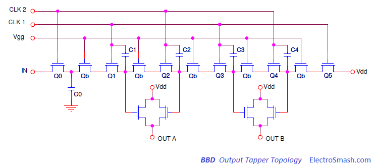

2.5 The Tapped Output Topology.
A buffer amplifier (NMOS source follower) can be used for non-destructive sampling of the capacitors. These measure points or taps permit to have multiple outputs with a different delay, which is very interesting in order to model reverb effects, mixing the different delayed output signals properly.Bucket Brigade Devices Tapper Output Topology

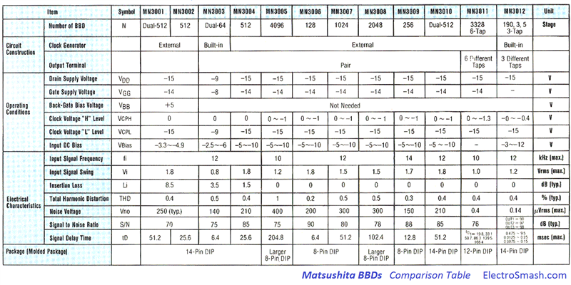

3. BBD Chips Comparison.
The most common BBD chips come from Panasonic/Matsushita MN3xxx series, with variants for high/low supply voltage and the number of stages.
BBDs Panasonic Matsushita Table

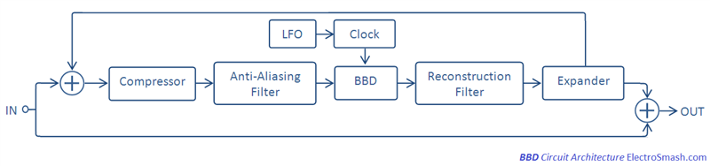

5. Typical Circuit with BBD Architecture.
The BBDs are found in delay based effects such as echo, chorus, reverb, vibrato, flanging or delay all of them share the same general circuit architecture:
Bucket Bridage Devices Architecture
Part of the input signal is processed through the BBD chain. Depending on the clock circuit the specific effect is created: the Low-Frequency Oscillator LFO is used for flanger/chorus/vibrato effects to automatically modify the delay time. For other effects like a simple delay, it is not needed.
The output of the delay line or part of it can be feedbacked into the input with variable gain, generating trailing echoes.
Before and after the BBD action, there are some stages needed to avoid signal degradation: Dynamic Range compression/expansion, Anti-Aliasing Filter and Reconstruction Filter:
  • Dynamic Range Companding (compression + expansion): These circuits allow wider dynamic range signals to be processed at the cost of altering the signal dynamics. In order to obtain low THD and good Signal to Noise ratio, the input signal has to be close to the maximum input level of the BBD.
In some cases, the compression and expansion take place outside of the anti-aliasing and reconstruction filters, while in others, the compander is implemented directly at the input and output of the BBD. Some BBD systems that require companding utilize the 570/571 series chips. This integrated circuit consists
of a pair of variable gain amplifiers and signal level averagers.
  • Anti-Aliasing Filter: It is low pass filter used before a signal sampler, to restrict the bandwidth of a signal to approximately satisfy the Nyquist-Shannon sampling theorem. The sampled input signal must be bandlimited to prevent aliasing (meaning waves of higher frequency being recorded as a lower frequency).
  • Reconstruction Filter: Also called Anti-Imaging Filter is again a low pass filter used to construct a smooth analog signal from a sampled input. The output signal must be bandlimited, to prevent aliasing (meaning Fourier coefficients being reconstructed as low-frequency waves, not as higher frequency aliases).
  • Feedback path: The feedback path also varies from system to system; different circuits place it inside or outside of the compression and expansion circuitry.
Finally, the wet or processed signal is mixed with the dry original one, depending on this mix ratio the effect over the original signal will be more or less dramatic.

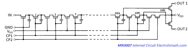

6. The MN3007.
The MN3007 core is based on the Bucket Brigade Delay circuit with an isolated triode and a differential output. It was included in popular designs like the DM-1 and CE-2 by Boss, Small Clone and Memory Man by Electro-Harmonix, AD-999 by Maxon or Analog Delay by MXR:
MN3007 Internal CircuitIt consists of a 1024 PMOS silicon stage that provides a signal delay from 5.12 to 51.2ms. The S/N is 80dB typ, THD of 0.5% typ (VIN=0.78Vrms), supporting a clock frequency range from 10 to 100KHz. The supply voltage range is from -10 to -15V.
