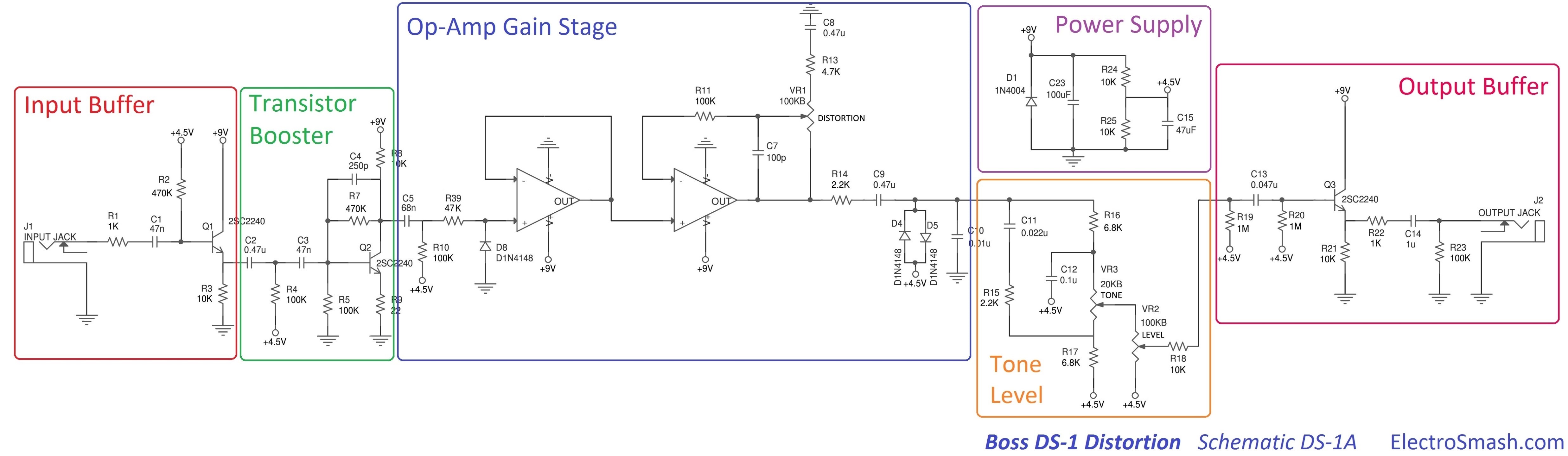

2. Boss DS1 Distortion Schematic.
The Boss DS1 circuit can be broken down into 5 big blocks: Input Stage, Transistor Booster, Op-Amp Gain Stage, Tone Control, Output Buffer and Power Supply.
The design idea is simple: The Input and Output Buffers will isolate the circuit, keeping the signal path clean and tone-sucking free. The transistor booster will pre-amplify the signal and all the distortion is produced using a variable op-amp gain circuit with diodes shorting the output to ground, producing hard clipping. This distortion stage is followed by a passive tone filter and level control. The Power Supply provides energy and bias points to all the circuit.
The circuit presented here is adapted to be used with a 3PDT switch, simplifying the circuit for DIY.

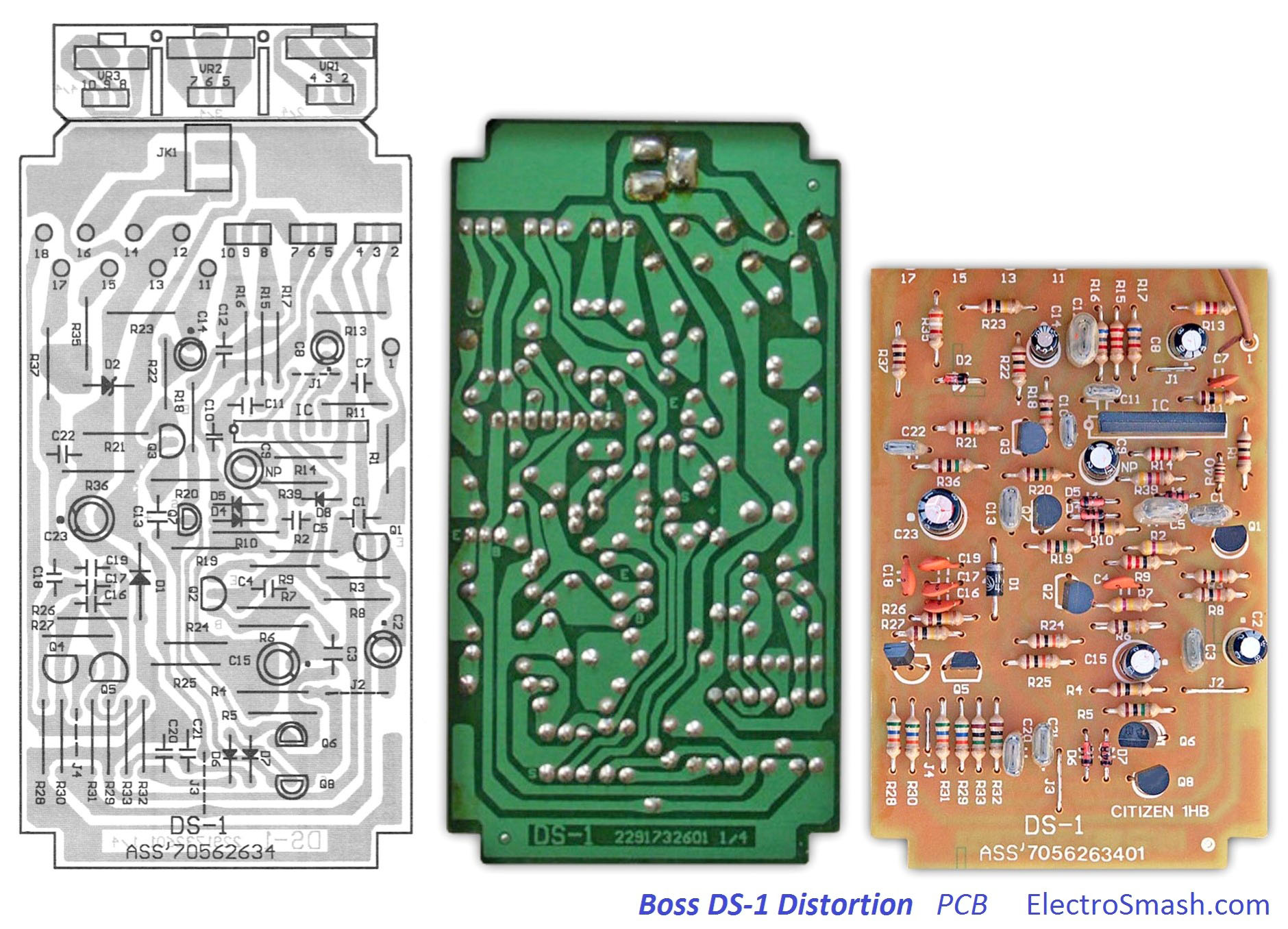

2.3 Boss DS1 Circuit Layout
The circuit uses a single layer PCB with standard through-hole components which makes it easy and cheap to produce. All the potentiometers, jacks and battery are wired and hand soldered which is quite labor intensive.
note: Original Images from gitaradiy.pl and miqbal on diystompboxes.com

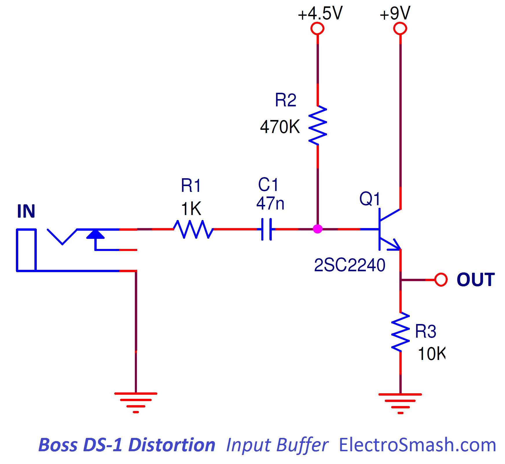

4. Input Stage.
The input buffer is a plain Emitter Follower (aka Common Collector) with unity gain and high input impedance that preserves signal quality eliminating tone sucking (high-frequency loss):
The Q1 part is a 2SC2240 Toshiba transistor, cheap low-noise/high-gain (β=200-700), nothing special here, it just does the job.
- The capacitor C1 isolates the guitar from any pedal dangerous DC level and filters the inaudible low-frequency signals with a cut frequency of 7.2Hz (fc=1/2πC1Zin)
- The R1 input series will protect the base of the transistor from surge currents (electrostatic discharges from the guitar jack tip).
- R2 is just a moderate high-value resistor that biases the base of the transistor to 4.5V.
- R3 is the emitter resistance, 10K is a pretty standard value for an Emitter Follower buffer.
4.1 Input Impedance Calculation.
In an Emitter Follower the input impedance can be calculated as β * Remitter , so the total impedance of the pedal is:
Zin= R1 +(R2//β*R3) = R2 = 470KΩ
note: the simplifaction of the formula (Zin= R2) is because the resistor R1 is too small compared to R2 (1KΩ<<470KΩ) and β*R3 is too big compared to R2 (200*10KΩ>>470KΩ), you can also make all the numbers and reach to the same conclusion.
If you want a further explanation of how to make all the numeric calculations, check the Tube Screamer Input Impedance Calculation; the circuit is very similar and all the maths are there.
470KΩ is a high input impedance to avoid loading guitar pickups and tone sucking, although the rule of thumb is to interface the guitar to an input impedance that is 1 MΩ minimum.

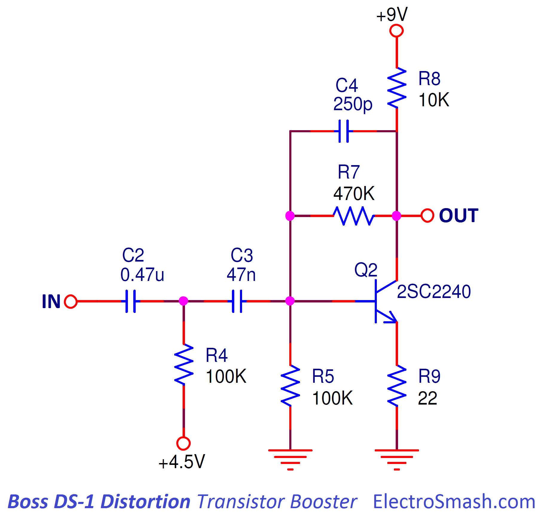

5. Transistor Booster Stage.
This stage applies some frequency filtering and signal boosting before the op-amp stage. The idea is to raise the signal levels so the next stage can work with acceptable levels although as we can see later, the signal is maybe too boosted after this stage.
The first part of this stage are 2 consecutive high pass filters:
- C2 and R4 with a cut frequency of 3.3Hz
- C3 and R5 with a cut frequency of 33Hz.
The basic idea behind this filters is to remove the excess of bass before the (next) distortion stage, a guitar signal with too much bass harmonics could make the distortion slow, dumped or muddy.

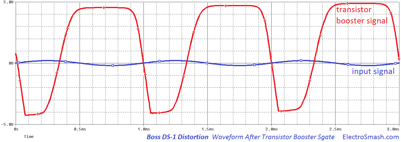

The transistor stage is a Common Emitter amplifier, the approx. voltage gain in this topology is collector resistance divided by the emitter resistance (RC/RE or R8/R9 = 10K/22 = 454 = 53dB), but the effect of the feedback resistor and capacitor (R7 and C4) will lower this gain to 35dB have to be taken into consideration.
The maths behind this topology so-called Shunt Feedback resistor are a bit complex and if you want to see the full numeric development check the Big Muff Pi Input Booster Stage, the topology is the same with some small values changes. In a nutshell, the original high gain (454) is reduced to a more sensible value of 56 (35dB) with better immunity to noise/temperature and oscillation.
However, a gain of 56 times is a huge amount of it, if we have a guitar input signal of 200mVpp, after the transistor booster the signal level is 11.2Vpp, the waveform will be distorted because the pedal supply is 9V. This gain will create a clipping that looking at the image below is asymmetric (cycles have a slightly different duration) and has a soft knee or soft clipping:
note: in the image above:
- Guitar input signal in blue color 200mVpp.
- Output signal after the Transistor Booster Stage in red color 9Vpp (clipped).

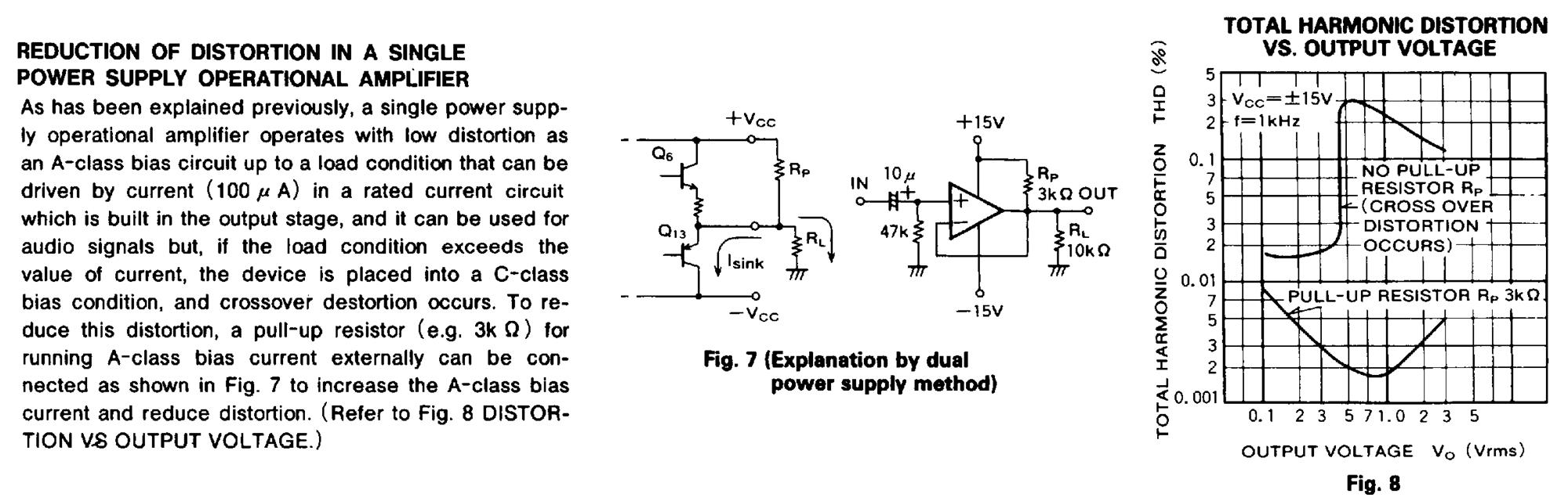

note: If you are using the Mitsubishi M5223AL op-amp you will need a 1K pull-up resistor from the second op-amp output to +9V. This resistor is labeled as R40 and will force the op-amp to work into class-A reducing distortion. Read the last page of the M5223A datasheet for more information.

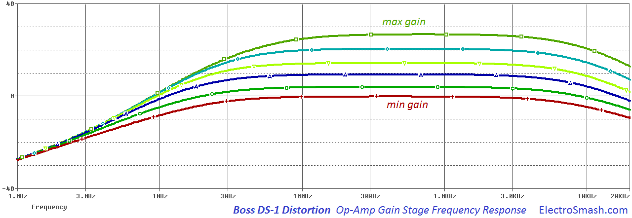

6.2 Op-Amp Gain Frequency Response.
The frequency response of the Op-Amp Gain stage is set in the low frequencies by the high-pass filter formed by C8 & R13 (fc=72Hz). Also, C5 & R10 reduce harmonics below 23Hz at the limit of the audio spectrum that will help either way to reduce oscillation.
On the high frequencies by the low-pass filter formed by R14 and C10 will attenuate harmonics over 7.2Khz, this is better explained in the section below. The cap C7 will also reduce harmonics at very high frequencies, softening a bit the distortion and reducing oscillation problems.
The minimum gain is 0dB and can go up to 26.5dB depending on the position of the distortion potentiometer, this amount of gain is not massive (the Tube Screamer has 41dB, the Proco Rat has 67dB) but the fact that the previous stage has a gain of 35dB makes that the resulting signal is completely clipped.

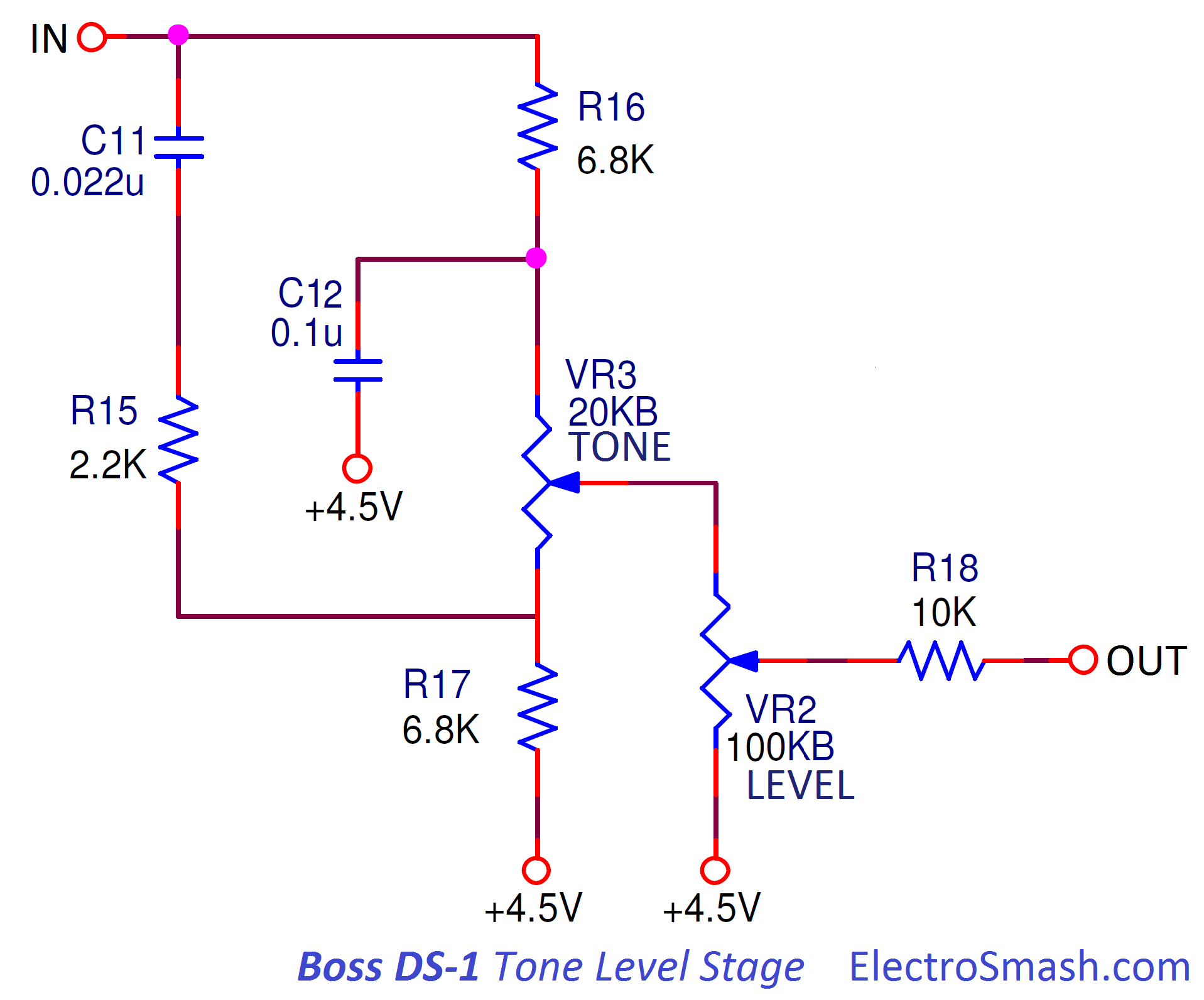

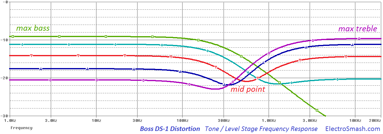

7. Tone / Level Stage.
The Boss DS-1 uses a passive Big Muff Pi style tone control, which scoops the mids and attenuates the lows or highs, depending on which way you turn the knob. The circuit consists of a simple fixed -6dB/oct low pass filter (formed by R16 and C12 with an fc=234Hz) and a fixed -6dB/oct high pass filter (formed by C11 and R17 with an fc=1063Hz) using the VR3 pot to mix the two signals. The cut-off points of both filters are calculated so that their interweaving effect create a frequency scoop/notch around 500Hz when the tone control is set to the middle position.
- After the initial tone shaping carried out by the first part of the circuit and the VR3, the VR2 pot regulates the level by bleeding part of the signal to AC ground.
7.1 Tone/Level Frequency Response.
The frequency response of the Tone control looks similar to the Big Muff Pi, the Boss DS-1 has a scoop around 500Hz. This equalization enhance the bass and treble of the signal and is used in hard rock, other pedals like the Tube Screamer have a completely different approach boosting the mids creating a mid-hump.
There is an overall -12dB (4 times) loss and at the notch the loss is about -20db (500Hz) but there is no problem with this because in the previous stage after the diode clipping the signal has a 1.4Vpp amplitude, with -12dB loss the resulting signal will be 350mVpp (1.4Vpp/4times) which is fine for an output level and won’t distort the input stage of the next pedal on the chain or the guitar amplifier.

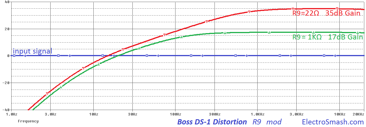

- The Transistor Boosting Stage has a huge amount of gain, it amplifies the incoming signal 56 times (35dB). This transistor overdrives the signal from the early stages of the pedal and will condition the behavior of the whole effect. This is the reason why a lot of mods like the ‘Vintage Ripper’, the ‘Fat Mod for DS-1’ or the ‘Huevos Grandes’ increase the size of R9 from 22Ω to 1KΩ, this makes the voltage gain of the Transistor Booster Stage to decrease from the default 35dB(56 times) to a more moderate value of 17dB (7 times).
In consequence, by replacing R9 for a 1K resistor, the signal gets boosted just 7 times (17dB), so any typical guitar input signal of 100mVpp after the transistor booster stage has a level of 100mVpp x 7 = 0.7Vpp a low level that will not clip the op-amp stage. This makes the user have a higher grade of control and variation; from a simple boosting to hard clipping.
In the image above you can see the difference between using an R9 of 22Ω (default) or using the 1KΩ resistor. Using the 1K value the amount of the clipping control is wider.
A bigger R9 applies negative feedback through the Q2 emitter and lowers the collector current. The emitter feedback reduces the distortion. Both the emitter feedback and the lower collector current decrease Q2’s voltage gain, which lessens the effect of the negative feedback through R7 and C4. By lessening the effect of R7 and C4, the low-freq cutoff from C3 is moved down and the high-freq cutoff from C4 is moved up. I think this is why people say that increasing R9 “flattens the frequency response”.
