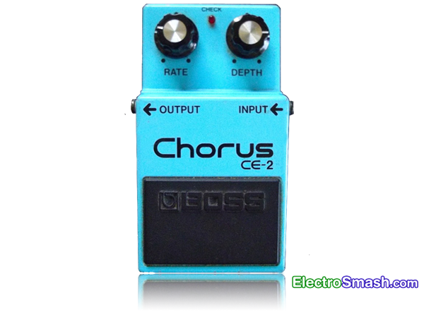

The Chorus Ensemble CE-2 is a chorus pedal by Roland/Boss released in 1979. It adds a dreamy modulated sound that creates a dramatic ambient guitar tone.
After the great success of the bulky Chorus Ensemble CE-1 issued in 1976, which was based on the Roland Jazz Chorus JC-120 Amplifier integrated chorus effect, Boss decided to revise and release a similar sounding effect but in a compact size modifying the circuitry. The CE-2 builds on the legacy of the CE-1 with reduced features: mono output instead of stereo, no vibrato mode, no integrated power supply, no level and no intensity controls.
The CE-1 was designed more to be a multi-instrument effect, with a 50K low input impedance suitable for keyboards. The CE-2 has higher input impedance and boosted mid frequencies, both arrangements very suitable for electric guitars.
Roland stopped marketing the CE-2 in 1982, however still produced until 1990. There are basically 3 versions of the pedal:

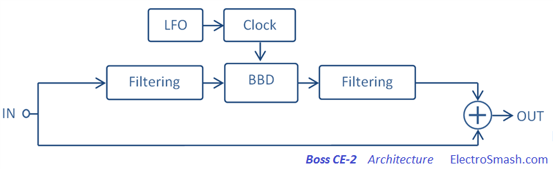

1.1 Chorus Effect Architecture.
The chorus is a delay based effect: the resulting sound is a mix of the original input signal and the incoming audio run through a BBD delay time device:
Before and after the BBD delay action, there are some stages needed to avoid signal degradation: Pre/De-Emphasis and Anti-Aliasing/Reconstruction filters.
The amount of delay to be applied is modulated by an LFO (Low-Frequency Oscillator). The usual delay times are around 5 to 50ms and LFO oscillating frequencies are up to 20Hz.

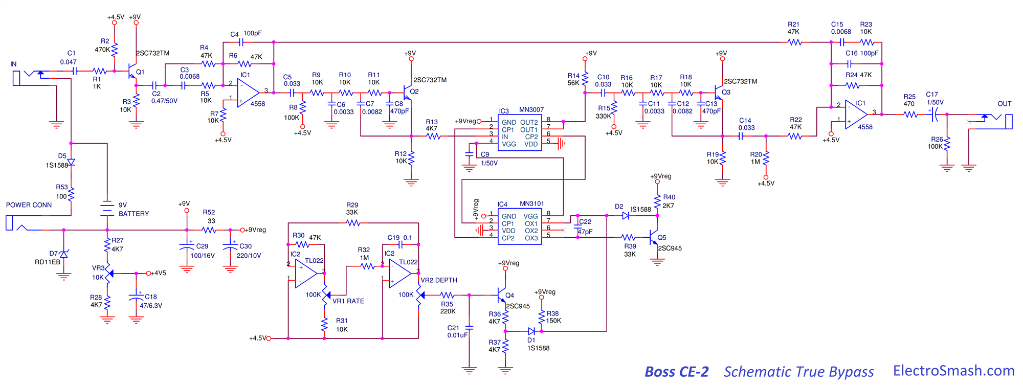

2. Roland/Boss CE-2 Circuit.

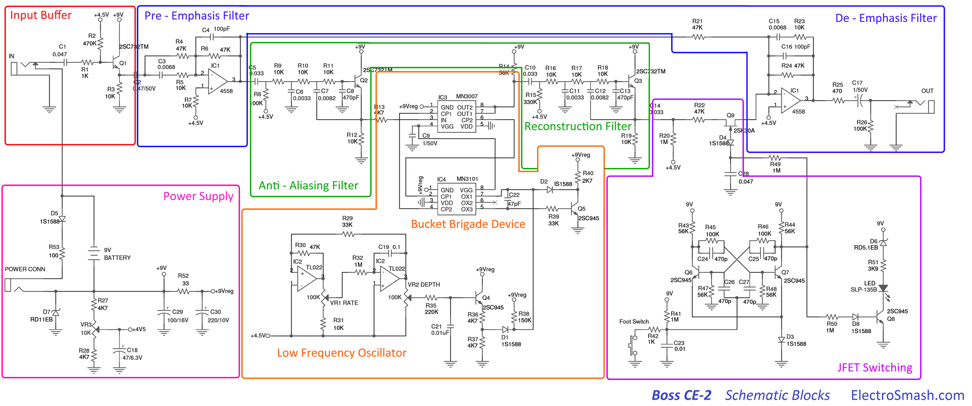

The CE-2 schematic can be broken down into some simpler blocks: JFET Bypass Switch, Power Supply, Input Buffer, Pre-De Emphasis Filters, Anti-Aliasing & Reconstruction Filters and Bucket Brigade Device Stage.
Note: The components are labeled following the original Roland/Boss PCB numeration.

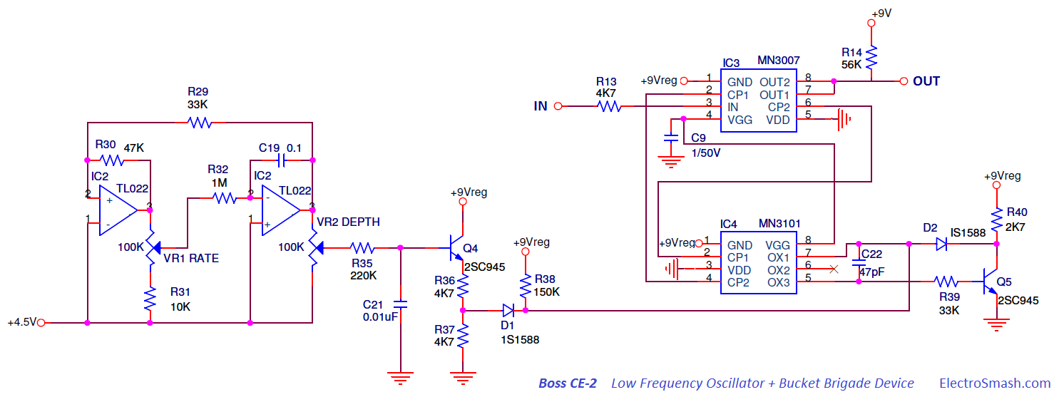

The circuit is designed around the MN3007 1024 stage BBD (IC3) and the MN3101 clock driver (IC4). The input and output circuits use the dual op-amp uPC4558C IC, while the LFO is implemented with the help of a TL022LP op-amp. Some additional active filtering is applied using Sallen-Key transistor stages.

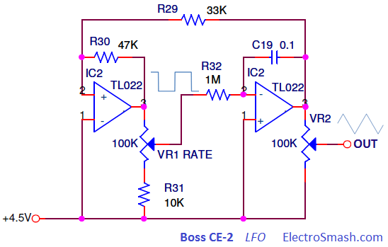

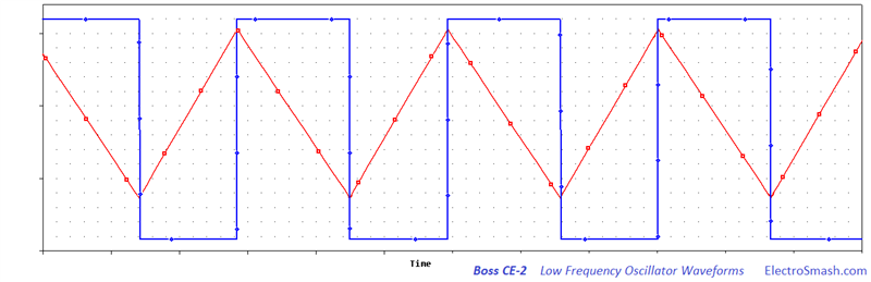

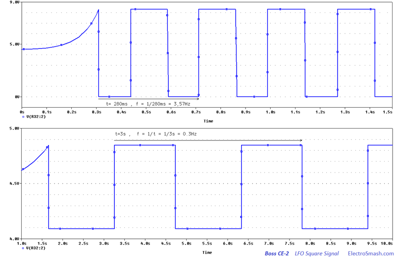

The effect response is commanded using two controls:
- The Rate knob adjusts the frequency of the LFO generator, adjusting the vibrato pitch.

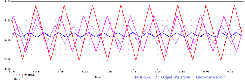

- The Depth potentiometer sets the amplitude of the LFO triangular signal, which is related to the amount of modulation.

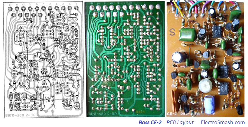

2.1 Boss CE-2 Layout.
The printed circuit board is designed to tightly fit into the standard boss enclosure:
It is a single layer PCB with insertion components. The top of the board contains all the pads to attach the cables to be connected to the jack connectors, potentiometers, and the footswitch.

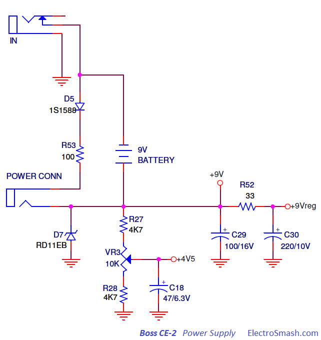

4. Power Supply.
The Power Supply Stage provides the electrical power and bias voltage to all the circuitry, the whole power consumption is low and estimated around 9mA:
– The diode D7 protects the pedal against adapter reverse polarity connections.
– The resistor voltage divider composed by R27, R28, and VR3), generates 4.5V to be used as a bias voltage in some stages. The resistors junction (+4.5V) is decoupled to ground with a large value electrolytic capacitor C18 47uF. The VR3 potentiometer is able to finely trim the 4.5 voltage: sometimes due to the loading of all stages, the 4.5 voltage might suffer some offset, the BBDs are sensitive to the bias, adjusting VR3 will bring maximum clean headroom.

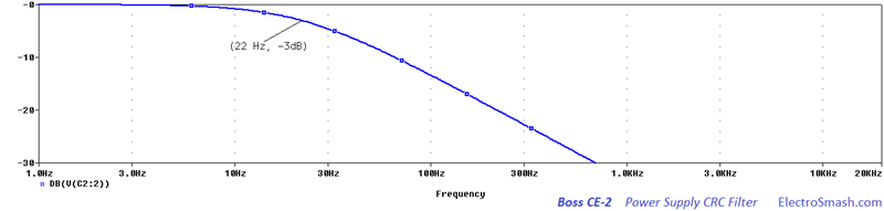

– The circuit formed by C29, R52 and C30 is a Pi CRC second order low pass filter, with an attenuation roll-off of –40 dB/decade over the cut-off frequency (22Hz). The 9V regulated line will bring the supply for the Bucket Brigade Stage, rejecting high-frequency harmonics which are especially harmful in BBDs signal processing due to the clocking noise of the MN3101 clock driver.
- The stereo in jack is used as an on-off switch, switching the battery (-) terminal to ground when the guitar jack is connected.
4.1 Boss ACA vs. PSA Power Supply Adapters.
The early Boss products like CE-2 with reduced power consumption used the ACA adapters which provide unregulated 12VDC (unregulated means that the output voltage drops when current consumption exceeds the maximum capacity, which is 250mA). This pedal was originally designed for an external 12V ACA supply adapter.
The series resistor R53 and diode D5 between the minus input on the power jack and ground are used to reduce the internal voltage supply.
V = 12V -VF = 12V – 1.2V = 10.8V.
With new products with higher power consumption, the PSA adapter was introduced which provides regulated 9VDC (regulated means that provide a constant voltage at any current under the max. capacity 200mA). This kind of adapter is the most common and used in all pedals nowadays.
In order to make the old ACA pedals compatible, the resistor and diode can be removed and replaced with jumpers.
The Daisy chain Trick: Powering the old CE-2 pedals designed for ACA 12VDC input with either a newer 9V ACA or PSA adapter will not work properly. The voltage drop over the resistor and diode will under-power the pedal making the power-on LED glow faintly. One easy solution is to use a daisy chain cable together with another standard pedal. The link between the two pedals will short the resistor-diode circuit and the pedal will receive full power.

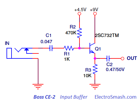

5. Input Buffer.
The task of the Input Stage Buffer is to create a high input impedance so as to preserve signal integrity and avoid high-frequency signal loss. It is implemented with a plain Emitter Follower with unity voltage gain (GV=1):
The 2SC732TM-GR NPN transistor is a cheap high gain (ß=200~400), low noise suitable for audio applications.
The capacitor C1 forms a high-pass filter filtering the low frequency humming in conjunction with the input resistors R1, R2 and the transistor stage input impedance. It also separates the guitar from any pedal DC potential, protecting the pickups in case of circuit failure.
5.1 Boss CE-2 Input Impedance.
In order to calculate numerically the input impedance of the emitter follower, the hybrid-pi model can be used for analyzing the small signal behavior.
The analysis of this parameter is similar to the Tube Screamer input stage, if you want to follow all the mathematics check the Tube Screamer Input Impedance Calculation, otherwise just stick to the general formula:
Therefore, the CE-2 input resistance is 407K, almost the value of the biasing resistor R2 (470K) which accounts for almost the entire signal loading at the input.

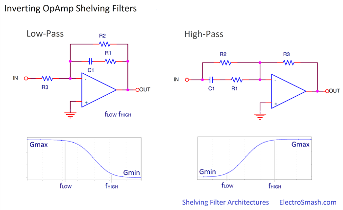

6.1 Shelving Filters with Operational Amplifiers.
The Shelving architecture is simple first-order filter function characterized by a frequency response with two different gains: GainLOW and GainHIGH between frequencies much higher and much lower than the corner frequencies.
This filters can be implemented over operational amplifiers, using inverting or non-inverting topologies. Boss CE-2 uses the op-amp inverting architecture.
Note: In order to achieve clock noise attenuation properly, inverting shelving filters (pre & post) are mandatory. Blending non-inverting & inverting will give mismatched gain & frequencies. The nature of non-inverting topology provides no attenuation and minimum gain=1. Only inverting topology offers both gain & attenuation, and both low & high inverting shelving filters share exactly same resistors & capacitors in reverse order, yielding matched frequencies and desired opposite gains, and this is why they are used in the Boss CE-2.

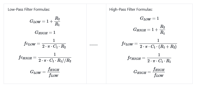

6.1.1 Inverting OpAmp Shelving Filters.
Low-Pass Filter Formulas:
High-Pass Filter Formulas:

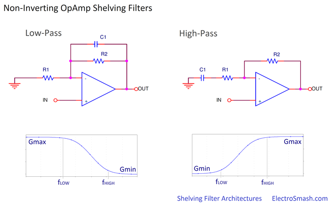

6.1.2 Non- Inverting OpAmp shelving Filters:
If R1 were much smaller than R2, there would be a 20dB/decade roll-off between the two gains. If R2 is not so much less, then the slope never quite makes it to 20dB/decade before it flattens out to the high frequency gain.
Note: The ratio f HIGH/f LOW is equal to the ratio of Gain HIGH/Gain LOW. It is fixed, so if you want a lot of cut or boost in the shelf, then the frequencies where the shelf starts and ends will be further apart and vice versa.

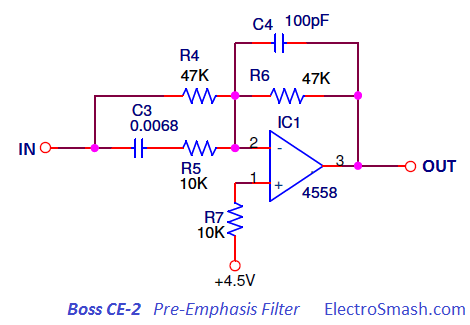

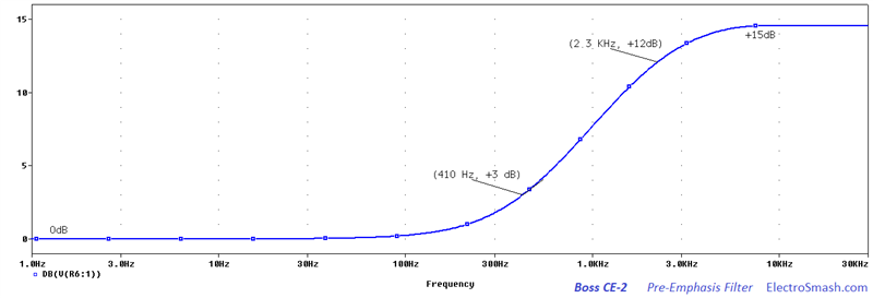

6.2 Boss CE-2 Pre-Emphasis Filter.
The active Pre-emphasis Filter formed by the 4558 dual op-amp is designed to increase the magnitude of the high frequencies with respect to the mid-low frequencies, in order to enhance the overall S/N ratio by minimizing the adverse effects of attenuation and distortion created for the BBD stage:

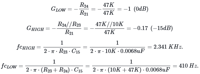

For the lows, the caps C3 and C4 are considered open circuits, leaving 47K at the input and 47K feedback and therefore resulting in a gain of 1. For high frequencies, there is a parallel path using 6n8 cap and 10K resistor, providing a gain of 5.7 above 2.4 KHz.
- The small 100pF C4 capacitor across the feedback loop works as a low pass filter, mellowing out the high end of the signal and limiting the bandwidth which is a classic arrange in stompboxes input stages that also maintain HF stability.
Pre-Emphasis Filter Frequency Response
As mention above, this circuit emphasizes the frequencies over 410 Hz. At 2.3KHz the gain keeps still at 15dB.

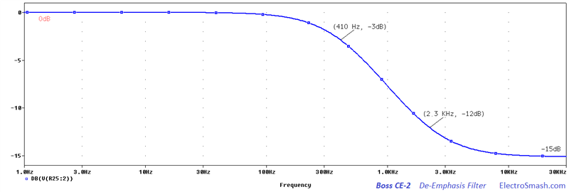

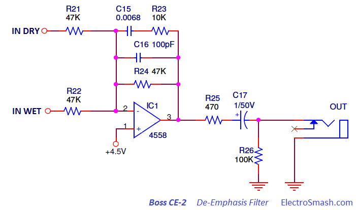

6.3 De-Emphasis Filter.
The De-Emphasis Filter is the complement of the Pre-Emphasis Filter. It is also implemented over the 4558 dual op-amps and designed to attenuate the magnitude of the high frequencies with respect to the mid-low frequencies. This filter takes the unnatural sounding pre-emphasized audio and turns it back into its original response.
The op-amp is configured in the classic summing amplifier topology, the equal size of the weighting resistors R21=R22=R24=47K indicates that the mix ratio between the dry and the wet signal is 50%.
To implement this filter, the same 6n8/10k previously used in the input stage is used in the feedback loop providing complementary treble cut over 2.34 KHz
- The small 100p C16 capacitor across the feedback loop works as a low pass filter, mellowing out the high end of the signal and limiting the bandwidth which is a classic arrange in stompboxes input stages that also maintain HF stability.
De-Emphasis Filter Frequency Response
As mention above, this circuit attenuates the frequencies over 410 Hz. At 2.3KHz the gain keep still at -15dB.

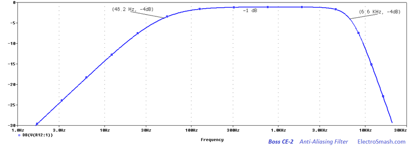

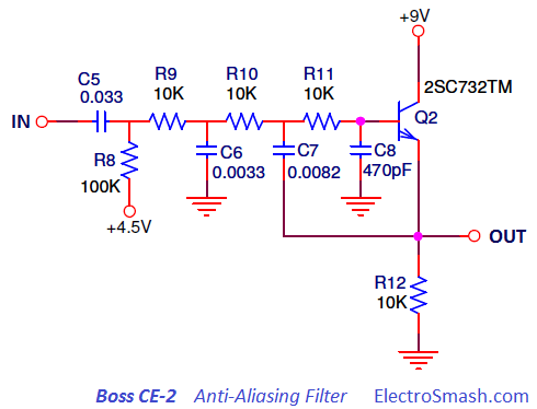

7.2 Boss CE-2 Anti-Aliasing Filter.
The Anti-Aliasing Filter is an active low pass filter used before the signal sampler (BBD) in order to restrict the bandwidth of the signal to approximately satisfy the Nyquist-Shannon Sampling Theorem. In this way, the input signal is bandlimited to prevent aliasing.
Just before the anti-aliasing low pass filter, there is another passive high pass filter formed by R8 and C5, generating a cut-off frequency of 48Hz that will bandlimit and cut the humming of the incoming signal. The cut-off frequency can be calculated as:
Frequency Response of Anti-Aliasing Filter:
The frequency response is a band-pass filter, letting the harmonics between 48 Hz and 6.6 KHz. The low pass cut-off frequencies can be calculated as mention before, the poles are at fc1 = 6,6 KHz and fc2 = 6,9 KHz

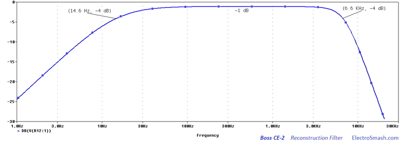

7.3 Boss CE-2 Reconstruction Filter.
The Reconstruction Filter also called Anti-Imaging Filter is again a low pass filter used to construct a smooth analog signal from a sampled output. The output signal must be bandlimited, to remove the clock noise and prevent aliasing (meaning Fourier coefficients being reconstructed as low-frequency waves, not as higher frequency aliases).
Just before the anti-aliasing low pass filter, there is another passive high pass filter formed by R15 and C10, generating a cut-off frequency of 48Hz that will bandlimit and cut the humming of the incoming signal. The cut-off frequency can be calculated as:
This 14.6 Hz cut-off frequency seems to be the only difference between the filtering after and before the BBD, which is indeed mirrored. After the delay stage, slightly more bass pass through the circuit.
Frequency Response of Reconstruction Filter:
The frequency response is a band-pass filter, letting the harmonics between 14.6Hz and 6.6 KHz. The low pass cut-off frequencies are the same as in the Anti-aliasing filter because the circuit is exactly the same (fc1 = 6,6 KHz and fc2 = 6,9 KHz).

In summary, the cap C22 47pF is charging-discharging at a fast rate (set by the Q5 astable), but the starting voltage level of C22 is commanded by the LFO signal, sent through the Q4 buffer:
- The Q5 transistor forms an RC astable oscillator with the MN3101. It is used to discharge the C22 47pF timing capacitor, which is charged through the R38 150K resistor. Indeed, Q5 together with the MN3101 will oscillate by itself at a constant frequency without Q4 and its associated components.
When the output of the double series inverters (pin 5) in the MN3101 goes high (in response to the cap charging to the CMOS threshold voltage as monitored by MN3101 pin 7) Q5 turns on and discharges the cap, and the MN3101 output goes low again, turning the transistor off and allowing the cap to re-charge. The cycle repeats at an ultrasonic rate.
- The Q4 transistor is an emitter follower that provides buffering to the triangle waveform from the LFO.
Immediately after C22 discharge, the diode D1 is needed to isolate the output of Q4 transistor. This diode serves to charge it up again to an “offset” voltage corresponding to the present voltage at the LFO output.
Actually the capacitor offset charging voltage = (VoutLFO – Vbe)/2 – VFdiode

The chorus effect is created by the slow modulation of the delay time using a Low-Frequency Oscillator (LFO). As the LFO cycles, the delay time goes up and down and therefore the delayed audio pitch slightly shifts up and down.
The LFO is implemented using a dual op-amp TL022 in cascade; this op-amp has a low current consumption, which is good to prevent ticking in the power supply. Some ticking can be mixed with the audio when the LFO produces the rising or falling edge of a square wave and there is a very sudden surge in the current.
The first operational amplifier in the chain generates the square wave, while the second operational amplifier generates the triangle signal.
This simple circuit provides a variable frequency triangular waveform whose amplitude is also variable.
After the second op-amp, there is a low pass RC filter (R35 C21) with a cut-off frequency of 72Hz (1/2πRC) which filters the LFO signal, removing all possible high-freq ticking noise.
- The first op-amp is in a threshold detector in positive feedback Trigger-Schmitt configuration.
The oscillation frequency can be calculated following the formula of the Triangle Oscillator by Ron Mancini:
With Rate control at maximum position, the oscillation frequency is 3.5Hz, this value will decrease as the VR1 pot is trimmed.
- The second op-amp is an Integrator which generates the ramp. The action of VR2 will modify the steepness of the ramp and therefore the amplitude or depth at a fixed frequency.
